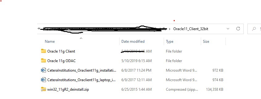

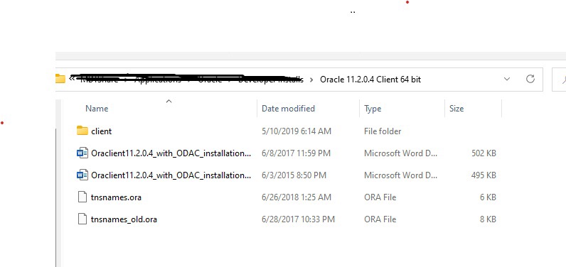

  2. TechUST 601 Reputation points
    2023-07-20T20:41:46.2233333+00:00
    Hi XinGuo-MSFT, Thank for replaying,
    I need to create for package for 32 and 64 bit but i have package in two folders i am not sure where should i copy batch file which you have shared also do i need to create two packages for 32 and 64 bit or can be packaged with single deployment.
    as per screenshot please suggest.
  3. XinGuo-MSFT 22,226 Reputation points
    2023-07-21T09:18:14.35+00:00
    A single deployment is ok, and all manual operations are converted to bat script implementations.
