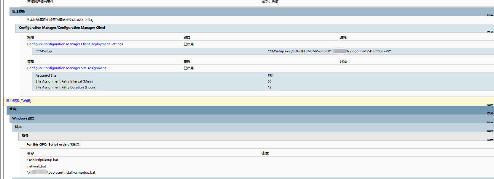

SCCM client installation failed, a total of about 1800 devices were identified, after nearly two months, only about 520 device clients were successfully installed.
Two methods of pushing the client through SCCM console and group policy delivery were tried.
This was the mathod group policy delivery.

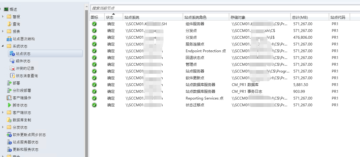

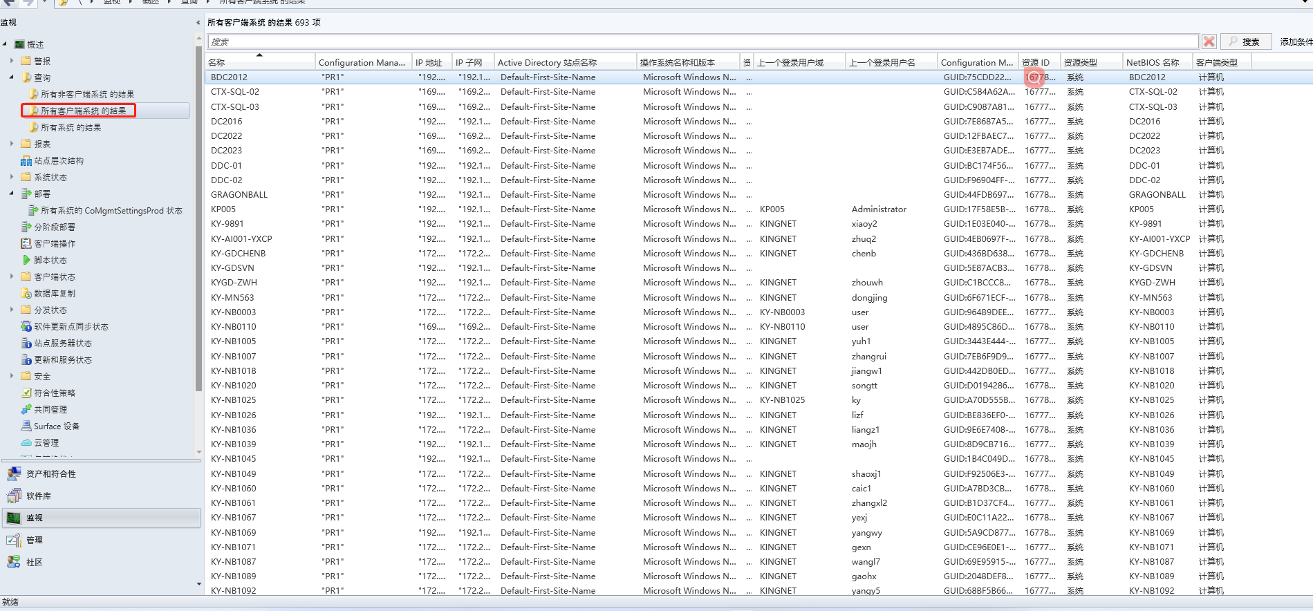

This are my Site Status.

    On your failed machines, does the GPO applied correctly? Can you see the ccmsetup folder under %WINDIR% ? What does ccmsetup.log says?

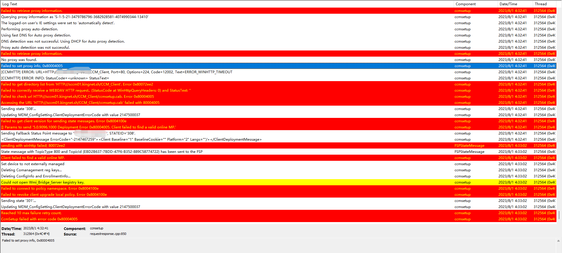

    Thank you for posting in Microsoft Q&A forum.
    The error code 0x8004100e means "Invalid namespace" and 0x80072ee2 means "The operation timed out".
    1,Please check your boundaries and boundary groups configurations, and associate your MPs and DPs to the boundary groups. Make sure the client can communicate with the MPs and DPs.
    1. Please also make sure your Firewall doesn't block the communication between the client and site system servers.
    For more detailed troubleshooting steps, please refer to the helpful article:
    Troubleshooting SCCM ..Part I (Client Push Installation )
    Thanks for your time. Have a nice day!

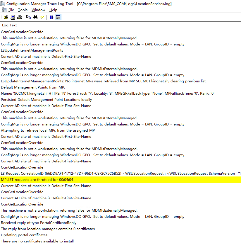

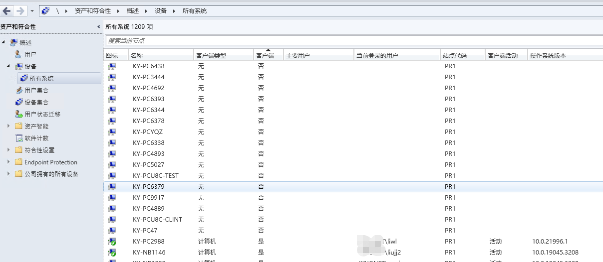

    Hello, I want to ask another question, some computers recognize the site code, but the client still shows No, what caused this situation?(as shown in the image below) Best regards, Simon
    You should start the troubleshooting from the client installation log (ccmsetup.log).
    If you are pushing client remotely, take a look of ccm.log.
