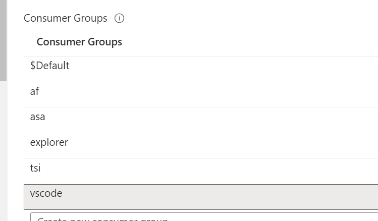

    Consumer groups are not to be reused by multiple consumers (azure resources listening to incoming iot hub messages).
    This could be Stream Analytics, Azure Functions, TimeSeries Insights, or even diagnostics tooling like Visual Studio Code or the IoT Explorer.
    Because all these tools use $default by default, a mistake is made quickly.
    Please use separate consumer groups for every consumer:
    Check the Built-in endpoints page in the IoT Hub.
