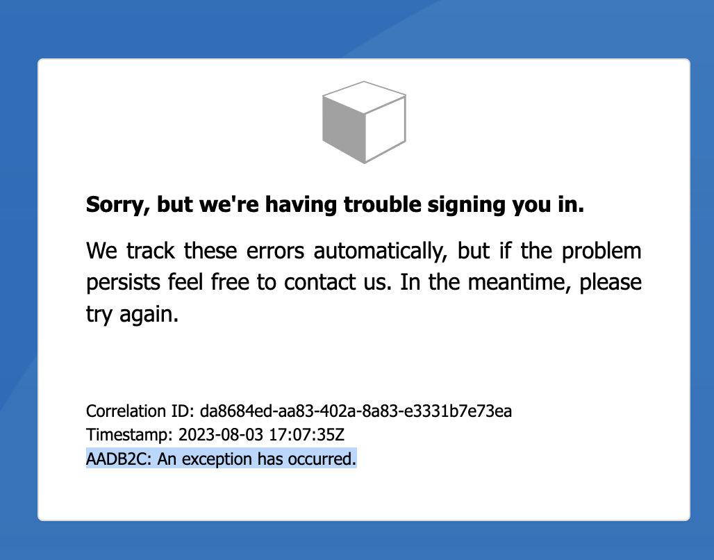

I tried multiple configuration, expecting Json object transformed to strings. But instead Azure errors with exception page.
