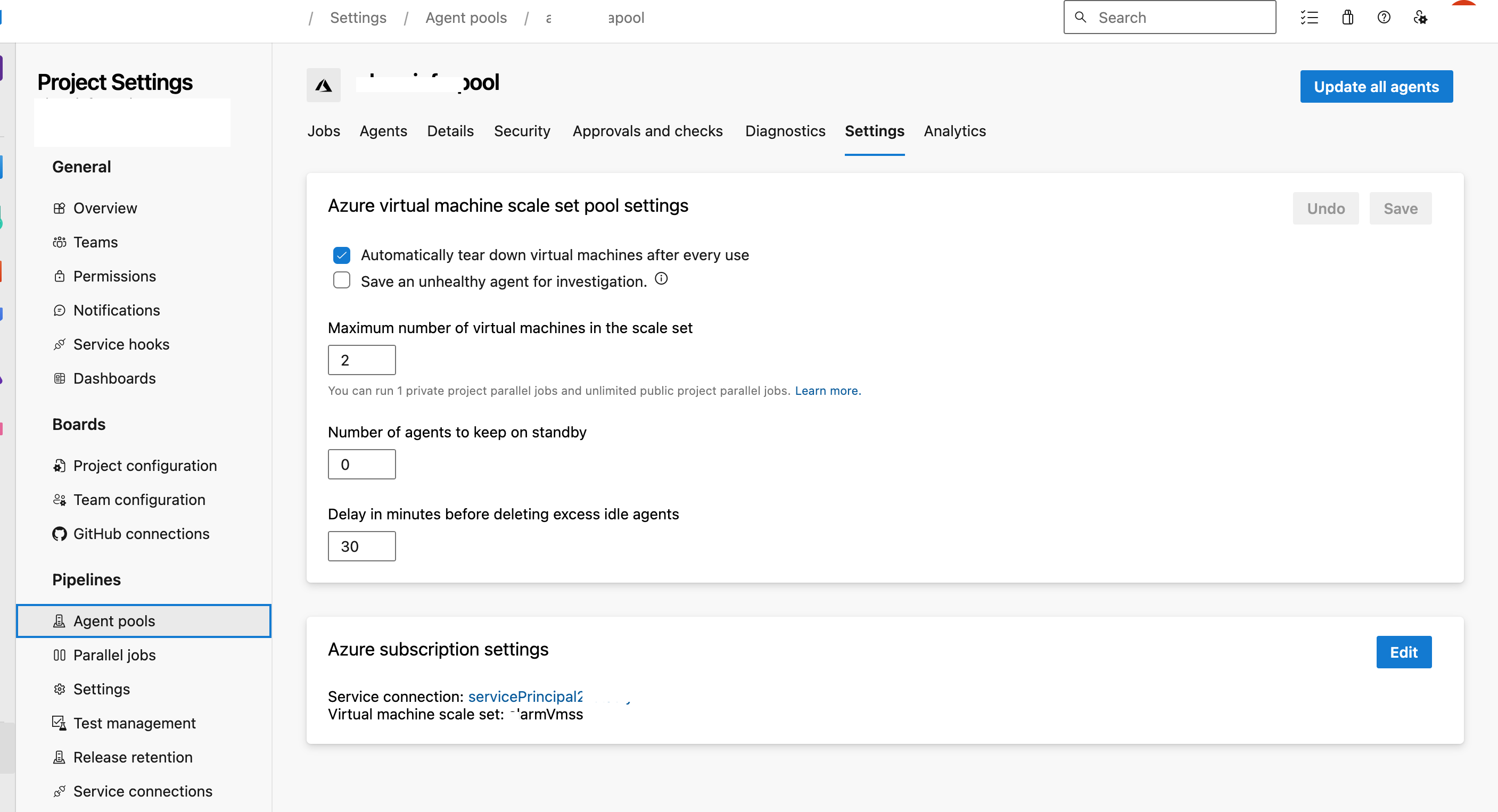

The private endpoints reside in subnetEndpoint in virtualNetwork vNetApp I have setup a DevOps pipeline using Self hosted agent. The agent makes use of a Virtual Machine scale set deployed in a virtual network agentSubnet in vNetApp.
enter image description here
