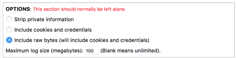

    We can use netlogs generated from the browser to identify the reason for these errors. To capture this data, follow these steps:
    • Open a new tab and go to chrome://net-export/
    • Select include raw bytes to see all the data in the stream.
    • Click the "Start Logging To Disk" button. It will create a json file, select a directory/path where you would like to save these logs to.
    • A lot of data is generated using this option, so be sure to set a maximum log size. enter image description here enter image description here
    • Reproduce the network problem in a different tab (the chrome://net-export/ tab needs to stay open or logging will automatically stop.)
    • Click Stop Logging button.
