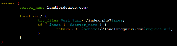

    @Xu Wang Thanks for reply! You may follow the steps mentioned in this blog to update the Nginx configuration file to redirect your users from azurewebsites.net & to your custom domain.
    1. Go to Azure Portal, open a new SSH session. (https://<your-site-name>.scm.azurewebsites.net/webssh/host)
    2. Update Nginx Default.conf - Server Block (Edit- file is under /etc/nginx/conf.d/default.conf)
    3. Update Nginx Default.conf - Location Block
    4. Save Changes
    5. Use command nginx -s reload to restart the Nginx Service & load the new configuration so that your redirects should be working as expected.
    Hope this helps. Let us know.

  3. Xu Wang 40 Reputation points
    2023-08-10T04:51:15.45+00:00
    Thank you for your reply. It looks like my change is reverted back after a couple days again. I tried to create myconfig.conf. But not sure if the following screenshot is the right way because the original default.conf has a lot of other sections inside "server" while I only included the part I want to change. How does it know if it should use my new config file part? Thanks

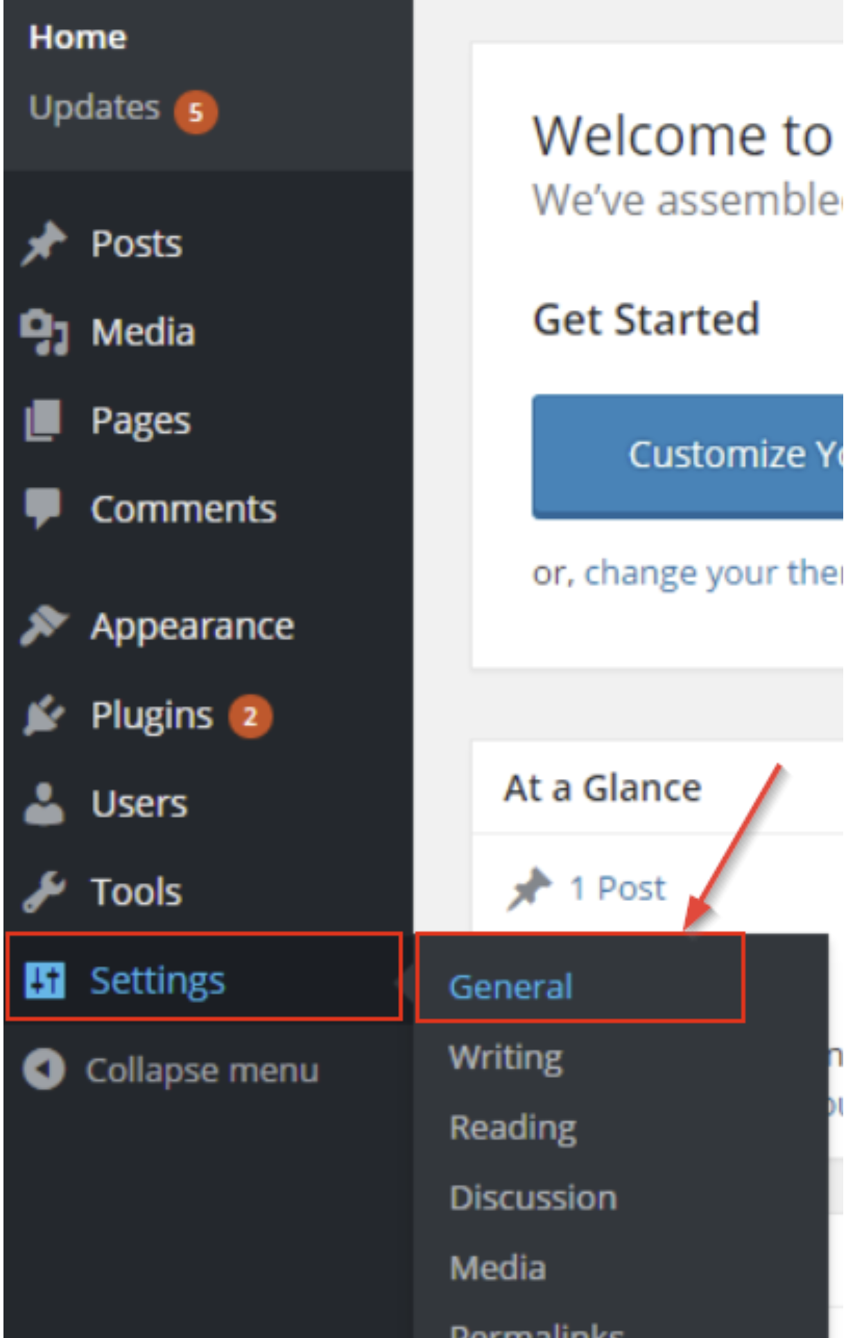

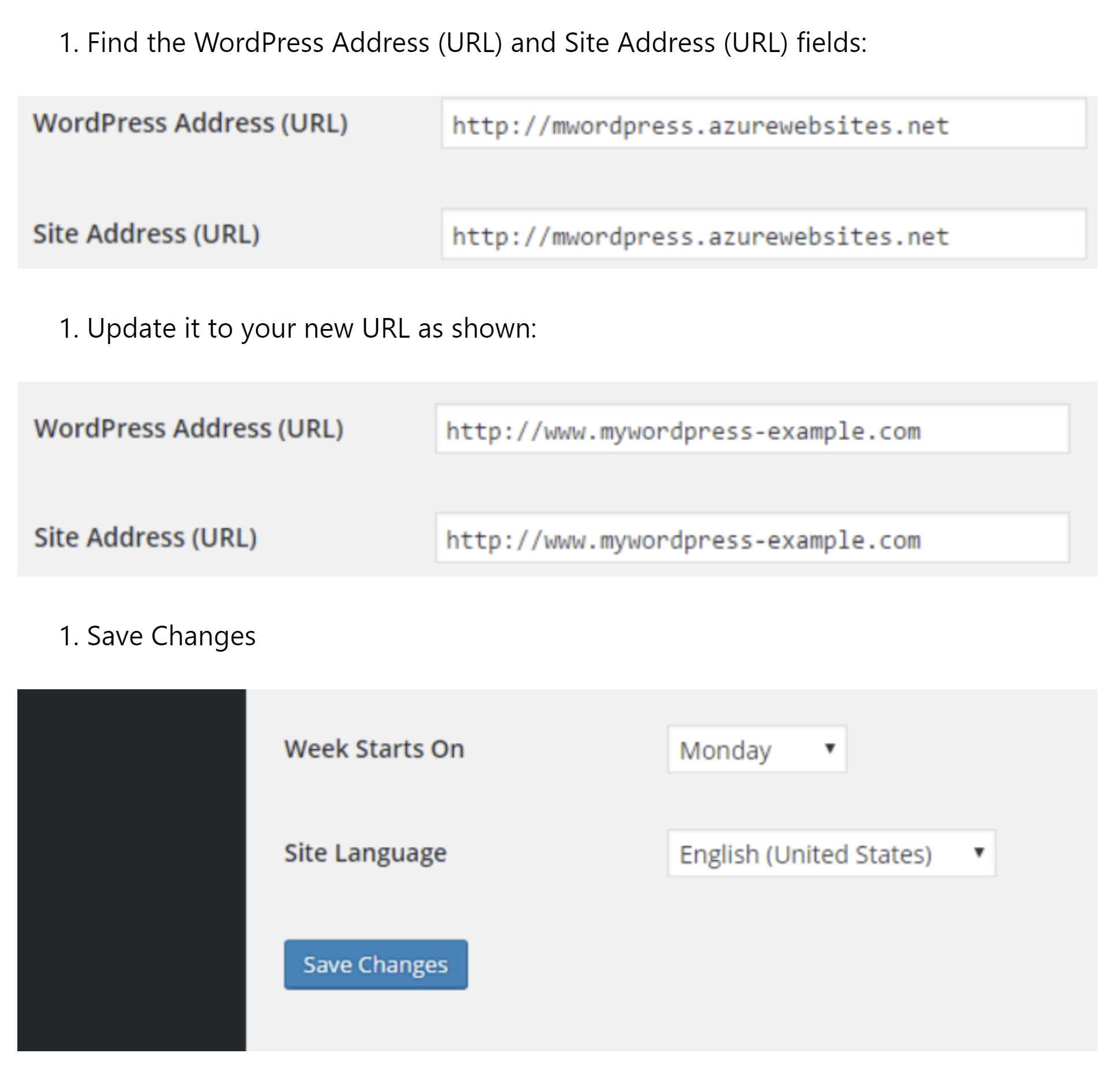

    But here's a step-by-step guide on how to successfully change the domain for your WordPress web app:
    1. Go to your app service and there go to the advanced tools blade and select go in there.
    2. This will open a site with a link similar to this https ://<yoursite>.scm.azurewebsites.net
    3. Add this to the URL https ://<yoursite>.scm.azurewebsites.net/newui
    4. In here go to the File manager blade
    5. After this navigate to your plugins folder, which should be .../site/wwwroot/wp-config.php
    6. In here write the following lines:
    define('WP_HOME','http://www.example.com');
    define('WP_SITEURL','http://www.example.com/site');
    For more in-depth instructions, you can refer to the comprehensive guide available at the following link:
