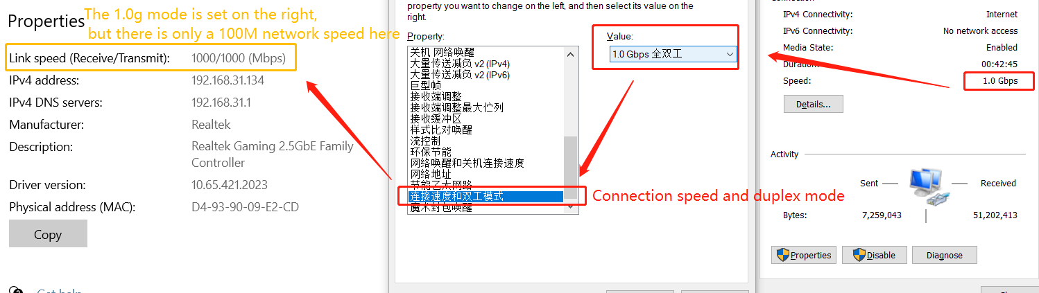

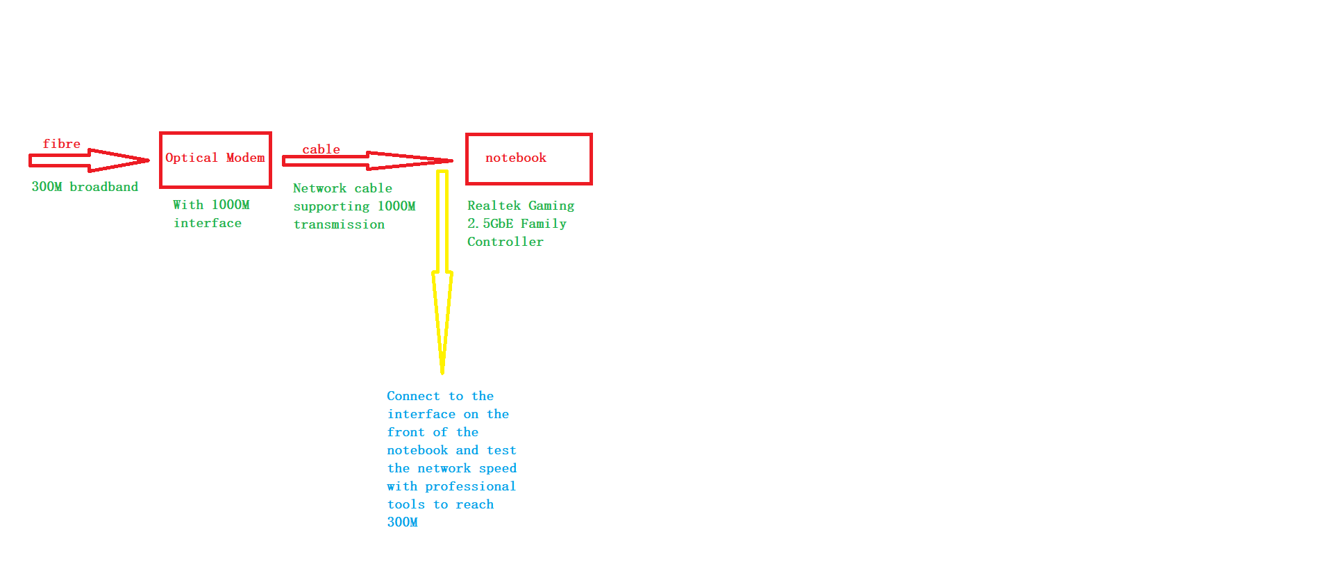

日记 花咪 20 Reputation points
2023-07-28T16:31:50.87+00:00
netword
Experimental method 1: Update and repair NICs Driver (failure)
Experimental method 2: modify DNS (failed)
Experimental Method 2: Qos Packet Scheduler (failed)
Experimental method 3: change to a laptop to test the network speed can reach the highest
The download speed of my computer is up to 11M/s, how can I get the highest speed?
thanks
c38c919f9919ba1d2c86d0f59e2b0bb
Windows for business | Windows Client for IT Pros | Networking | Network connectivity and file sharing
    2023-07-31T07:03:46.5133333+00:00
    Please make sure the NIC driver has been updated to the latest version. As shown in your screenshots, the link speed has already been set to 1000Mbps. Did you test with the same port of the optical modem and cable? Have you tested the speed to other devices directly connected to your notebook? If the speed is also 100Mbps, you will have to contact your notebook manufacturer.
