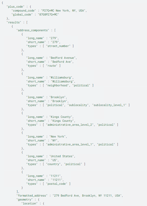

Can someone help me to find the below formatted address using google maps api. Attached is the file and I want to fetch the "formatted_address" . https://maps.googleapis.com/maps/api/geocode/json?latlng=17.7451253,83.3366575&key=MYKEY
"formatted_address" : "2-23-34, Sector- 6, MVP Colony, Visakhapatnam, Andhra Pradesh 530017, India"
Developer technologies | ASP.NET | ASP.NET Core
    2023-07-31T06:39:41.1966667+00:00
    Hi @KALYANA ALLAM
    Just like what you did using the virtualearth API, refer to you provide code, change the request URL to google API format:
    https://maps.googleapis.com/maps/api/geocode/json?latlng=40.714224,-73.961452&key=YOUR_API_KEY
    Set the latitude, longitude and change the API key to your actual google map API key. The response like this:
    After getting the response json string, you can also use JsonConvert.DeserializeObject method to convert the json result to an object, and then get the formatted_address value.
