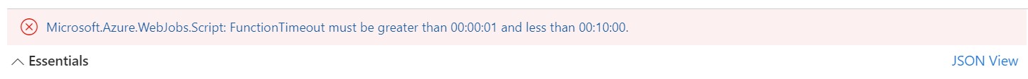

I'm currently getting a warning below:
Screenshot 2023-07-31 145254
I'm getting this in my Dev environment after I deployed it from a local project. In my local project, the function timeout is set to 1 hour and it works fine.
What might be the issue and how can I resolve it?

    Hello @Henry Chen,
    the message you get is by design.
    This is to protect you from unsuspected costs because time is part of the way (consumption plan) functions are billed.
    Azure Functions in the Consumption plan have a default timeout of 5 minutes and an upper limit of 10 minutes.
    If you need a longer timeout, you need to switch over to a different plan which provides longer timeouts and dedicated resources.
    If you want to extend towards that 10 minute limit, follow this guide.
