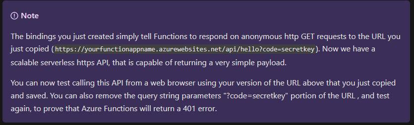

    Thanks to MikeUrnun I figured out that my configuration issue was the naming of my Azure Function. The request was being sent to an Azure Function that didn't exist - it was trying to call a function called "hello", when my actual function was left as the default name, so "HttpTrigger1". After I created another function named "hello", the system worked as planned.
    Just as MikeUrnun also mentioned, each step on the tutorial needs to be followed extremely closely! Any naming conventions need to be followed extremely closely.
