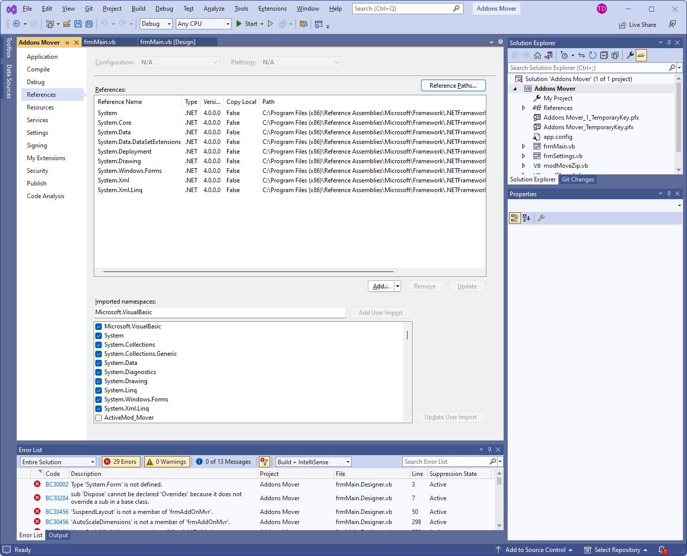

After being advised to switch my app's "DotNet" Framework from 3.5 to 4.5.2, the ".Designer" is now loaded with errors and I can't display my app in Design View.
Going back to 3.5 didn't help. "Rebuild" didn't help.
How do I undo the damage so I can get my program working again? :(

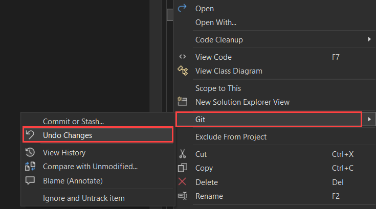

In regards to reverting changes to a file see how to revert changes to a single file. In Visual Studio, pulling up history, right click on a file and select revert. In GitHub desktop (which is what I use), select history, find the last good commit, right click and select revert changes in commit.
I followed the link on How to revert changes. It begins with "First you need to go to the shared repository on GitHub". Already I'm lost. I don't think a "Repository" was ever created or exists.
Under "Git" on the VS toolbar, the top 3 menu items are "Clone Repository", "Create Repository", and "Local Repositories | Open Local Repository" (which only shows empty folders.) I'm not finding a "History" anywhere.
The "Solution Explorer" tree lets me open another form in my project (frmSettings.vb) in Design View (b/c it does not contain any errors), but my "frmMain.vb" can only be displayed as code (I assume until the errors created by the DotNet conversion are fixed.)
In Solution Explorer, try right clicking on a file to revert, select Git then Undo Changes.
Thx for the follow-up, but "Git" is not listed as an option.
It doesn't look like you're storing your project on Git, and Visual Studio itself doesn't offer the ability to restore historical versions of your project.

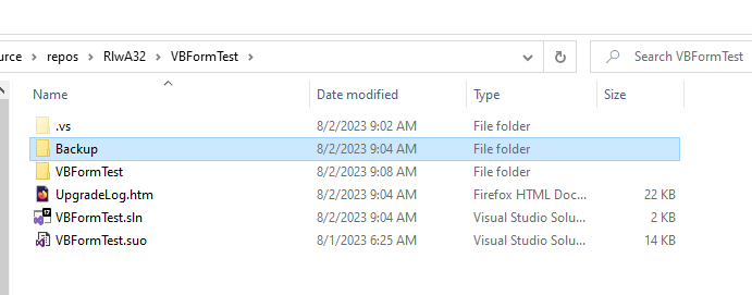

@Mugsy's RapSheet I created a VB Winforms project in an XP VM using VS2005. The VM used to create the project had .Net Framework 2.0 installed.
Then I moved the VB Winforms project to a Win10 System which has .Net Framework 4.8 and VS2022 installed.
When the VS2005 created project was opened in VS2022 this dialog was displayed -

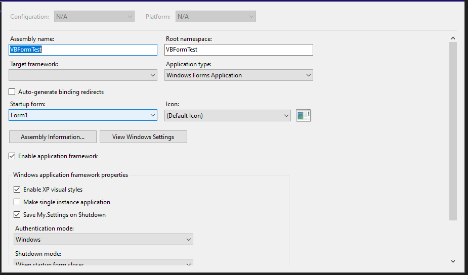

I clicked the OK button and VS2022 upgraded the project. I opened the project properties after the upgrade as seen here -
Note that the Target Framework dropdown is blank. The Win10 system doesn't have .Net Framework 20 installed and VS2022 doesn't target that old Framework version. I instructed VS2022 to Target the .Net 4.8 Framework and this warning was issued -
After VS2022 retargeted the project I opened the Form in the designer -

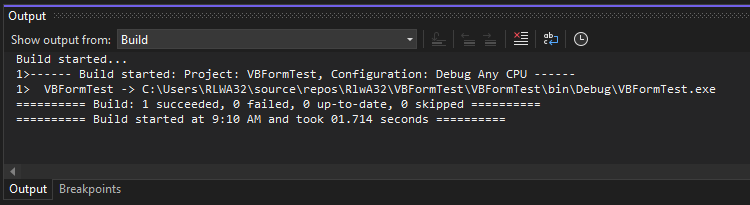

And the a successful build was performed.
Finally, the VS2022 Project Upgrade process backed up the original files in a newly created Backup folder -

After which, the Designer code was transformed in a manner such that it now reported 40 errors (see original screenshot) that prevented the form from being opened in Design mode.

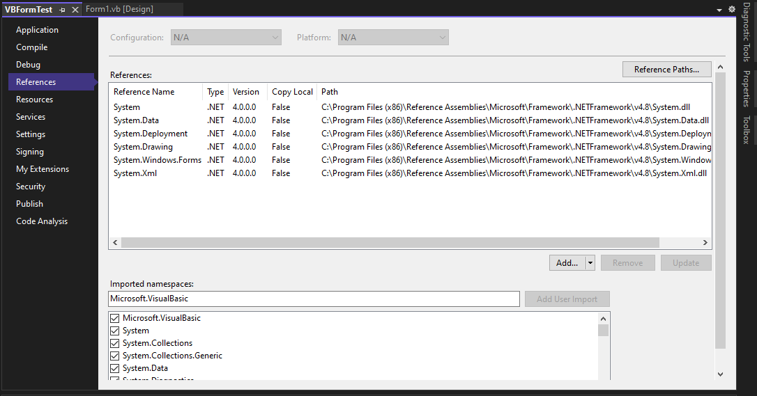

Open the Project Properties and select References. You should see something similar to this -
And what? What am I looking for?
Any indication that there is an error. Cannot find a path. Bad version number. Missing reference to System.Windows.Forms assembly
Everything appears to be in order.

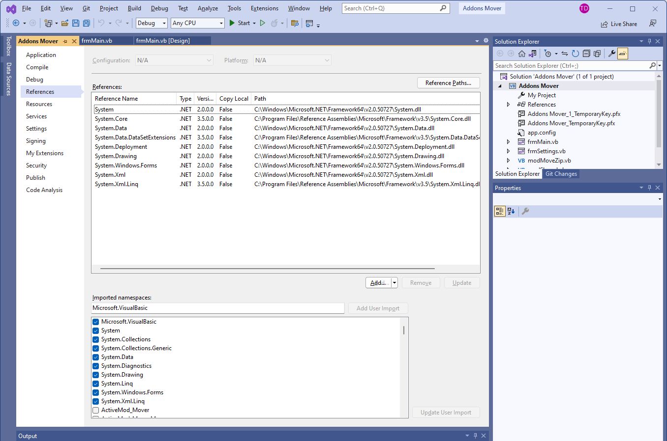

All the references are incorrect. They are pointing to the wrong versions.
First, go to project properties and verify that the Target Framework is actually 4.8
If the Target Framework says 4.8 then remove the incorrect references and and replace them with the equivalent version 4 Framework assemblies.
I had gone back to 3.5 to restore/repair my code.
Switching the Framework back to 4.8, all references changed to 4.0 and the code is broken again (29 Errors. frmMain won't load.)
