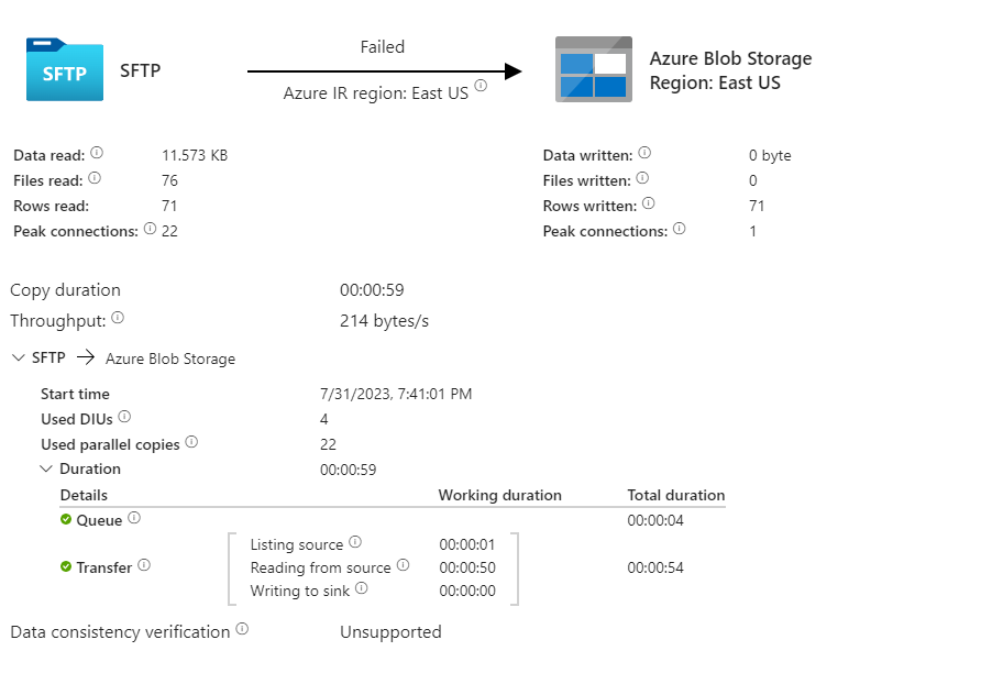

I tried by loading the multiple files from SFTP and coping the files as a single file to Blob account.
Able to read all the files but unable to merge the files. It was throwing timeout issue.
I want to figure out how many connections that the SFTP is taking and how the connection with SFTP will work..?
Error Message:
ErrorCode=SftpNetworkIssue,'Type=Microsoft.DataTransfer.Common.Shared.HybridDeliveryException,Message=Meet network issue when connect to Sftp server 'direct.dev.mckesson.com', SocketErrorCode: 'TimedOut'.,Source=Microsoft.DataTransfer.ClientLibrary.SftpConnector,''Type=System.Net.Sockets.SocketException,Message=A connection attempt failed because the connected party did not properly respond after a period of time, or established connection failed because connected host has failed to respond,Source=Renci.SshNet,'

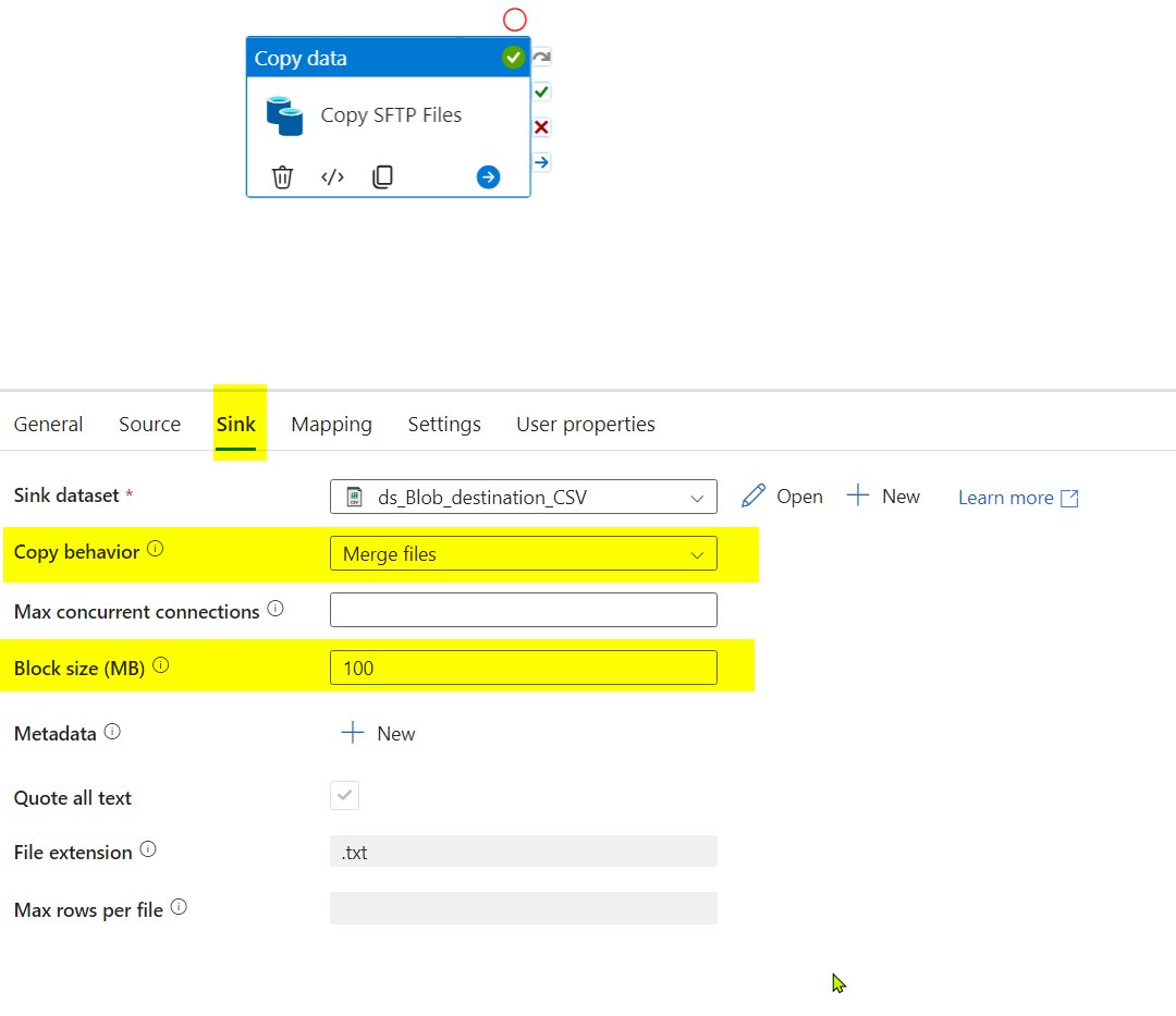

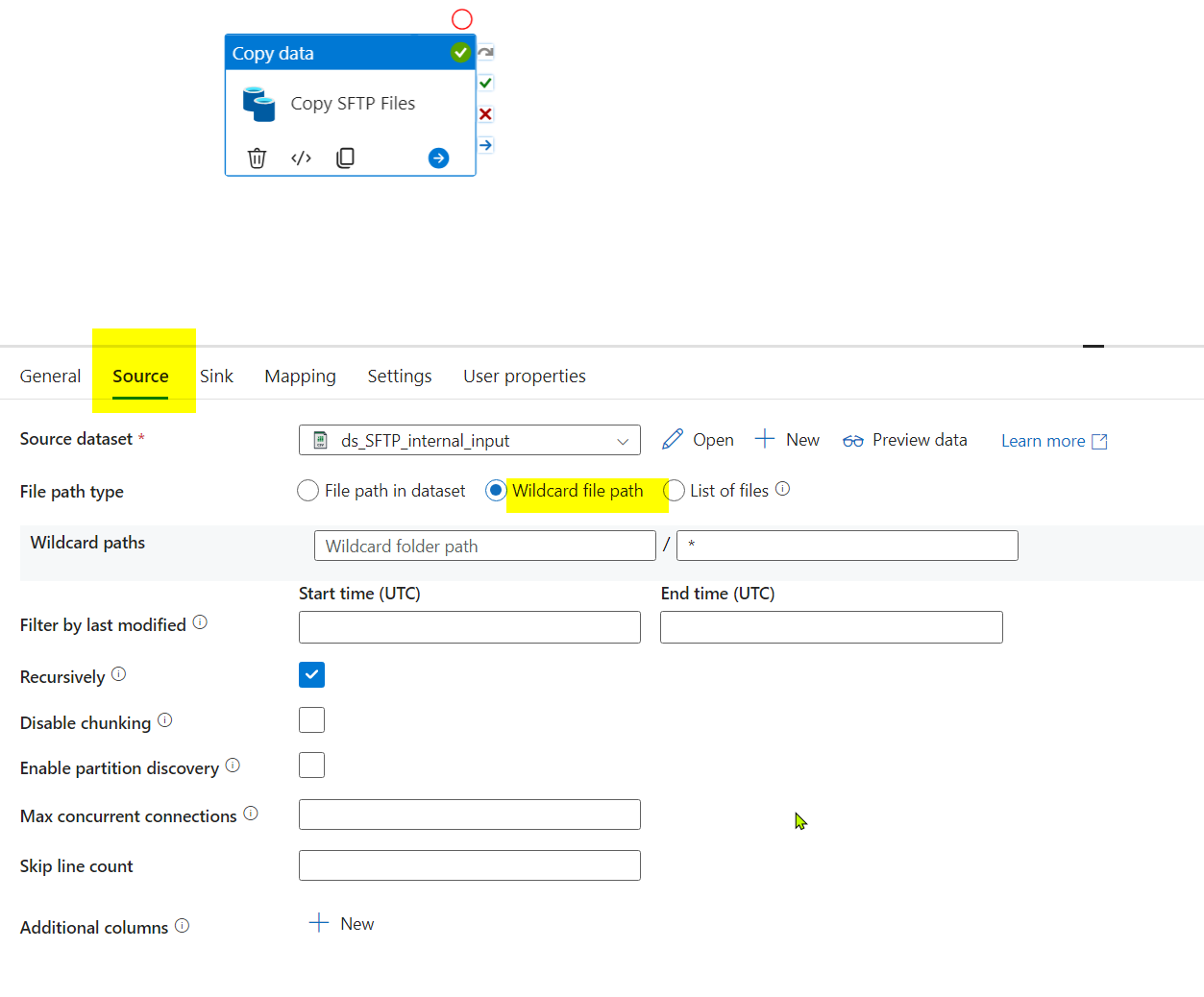

    I have tried the scenario in SFTP-->Storage copy activity.
    Source Settings:
    Read all Files from the SFTP location.
    Sink Settings:
    I used the 'Merge Files'
    and
    Block Size (MB)---> 100 max

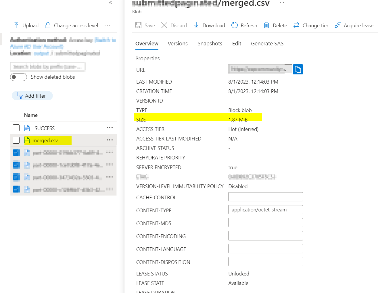

    Output
    All the files are written to a single destination file as merged content.
