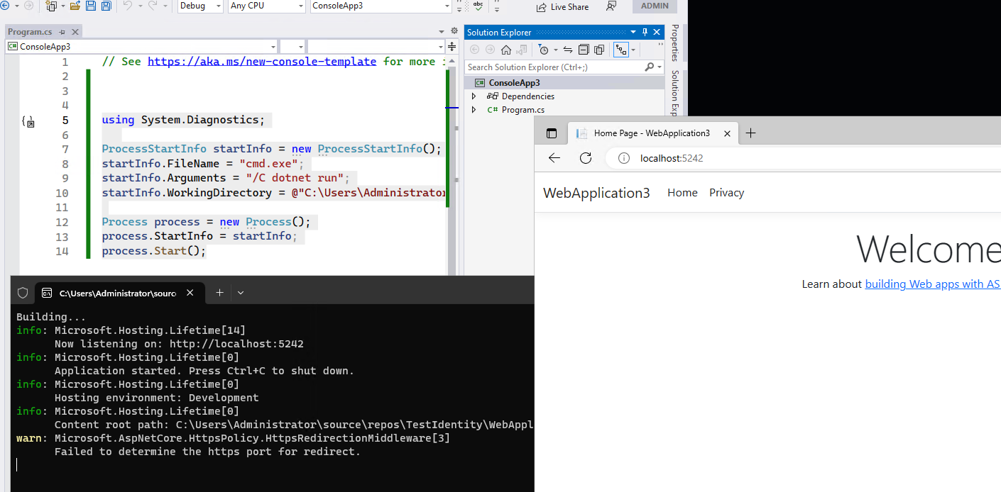

    Refer to the following sample: In the TestIdentity solution, there have a WebApplication3 project, I will use the following C# code (in a console project) to host the WebApplication3 project.
    using System.Diagnostics;
    ProcessStartInfo startInfo = new ProcessStartInfo();
    startInfo.FileName = "cmd.exe";
    startInfo.Arguments = "/C dotnet run";
    startInfo.WorkingDirectory = @"C:\Users\Administrator\source\repos\TestIdentity\WebApplication3";
    Process process = new Process();
    process.StartInfo = startInfo;
    process.Start();
    After that the result as below:
    You can replace dotnet run with any other command that you want to run.
