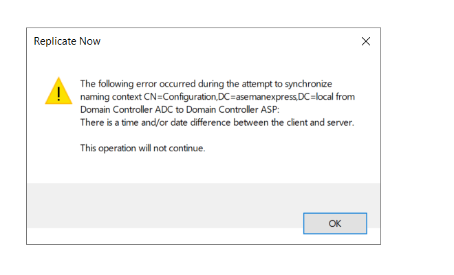

I have 2 domain controllers as primary and additional
this picture is that error and I don't really know what do I'll do
time and date are sync but still show this error
could u help me?

    Hi
    you may need to provide more info here, however some pointers to check:
    • DNS Settings are correct and DNS is healthy on your client and server devices?
    • Are you using Logon Scripts or GPO Startup scripts in your environment? Isolate a device to not process any GPOs and see if that makes a difference.
    • Make sure your Replication across DCs is healthy - use DCDiag and Repadmin to check this with the following commands:
    Dcdiag /v /c /d /e >C:\dcdiag.log
    repadmin /showrepl >C:\repl.txt
    • Check for any Internal Network issues?
    Report back with some more details and we can try to assist further.
