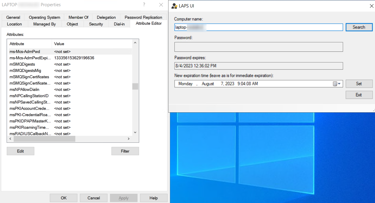

After server reinstallation, LAPS stopped working
Yavor Petrunov 20 Reputation points
2023-08-03T07:44:49.0833333+00:00
Greetings,
I have installed and deployed LAPS (Local Administrator Password Solution) on a new Windows Server 2022 Standard (21H2) with RSAT to the Domain Controller, using the following guide: https://techcommunity.microsoft.com/t5/itops-talk-blog/step-by-step-guide-how-to-configure-microsoft-local/ba-p/2806185. I tested it on a couple of computers and it worked perfectly. Unfortunately the server had crashed (for different reasons, nothing to do with LAPS) and I had to reinstall it, since I had no snapshots made for this virtual machine. I reinstalled LAPS exactly the same way, but now it doesn't update any passwords, nor giving new ones to newly joined machines. Both the logs of the server and the local machines show no information regarding LAPS, the only error that I get is this one, when I run Reset-LapsPassword:
Reset-LapsPassword : The request failed because the machine is not configured to backup the managed account password to either Active
 Directory or Azure Active Directory.
At line:1 char:1
+ Reset-LapsPassword
    + CategoryInfo          : NotEnabled: (:) [Reset-LapsPassword], LapsPowershellException
    + FullyQualifiedErrorId : LAPS is not enabled on this machine,Microsoft.Windows.LAPS.ResetLapsPassword

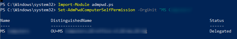

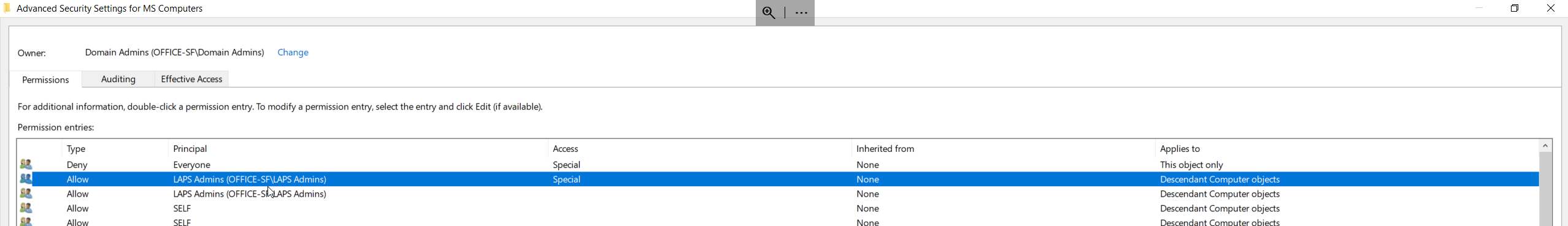

    We can check from the following three points:
    1.What account did you logon the management server? Does that account have permission to view the password.
    2.What object did you put in this OU (you run command on the OU Set-AdmPwdComputerSelfPermission -OrgUnit "OU=xxx,DC=xxx,DC=xxx")? We should put computer object.
    3.Whether all the computer machines in the OU have not generate password?

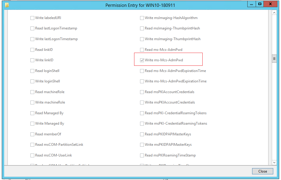

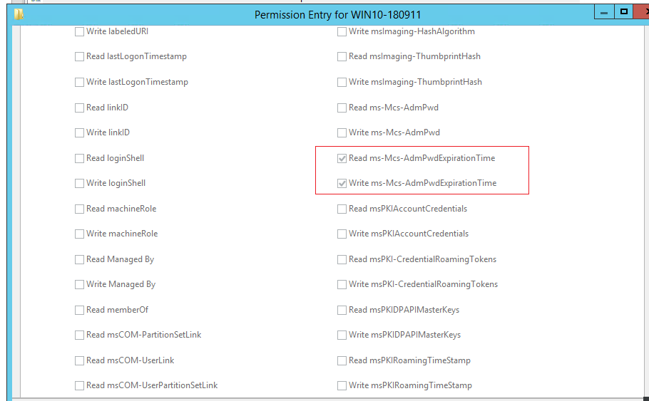

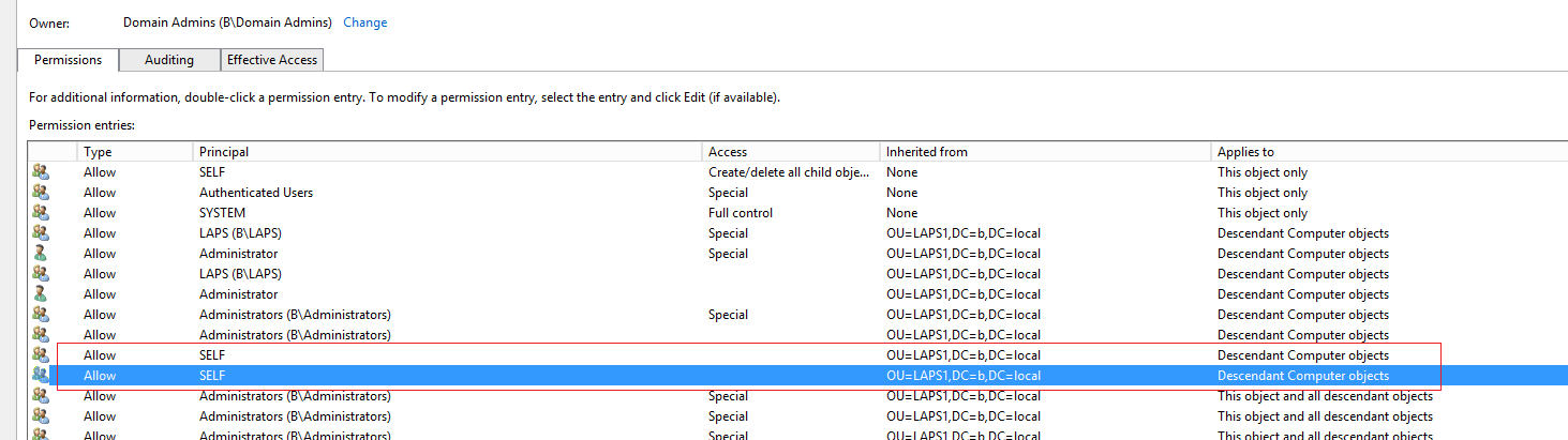

    If so, you can check the permission on the OU (for example).
    LAPS1

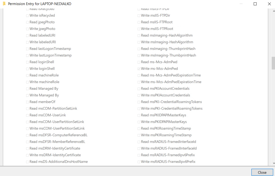

    4.And you can check the permissions on one machine.
    laps2
    laps3
    Hope the information above is helpful. If you have any question or concern, please feel free to let us know.

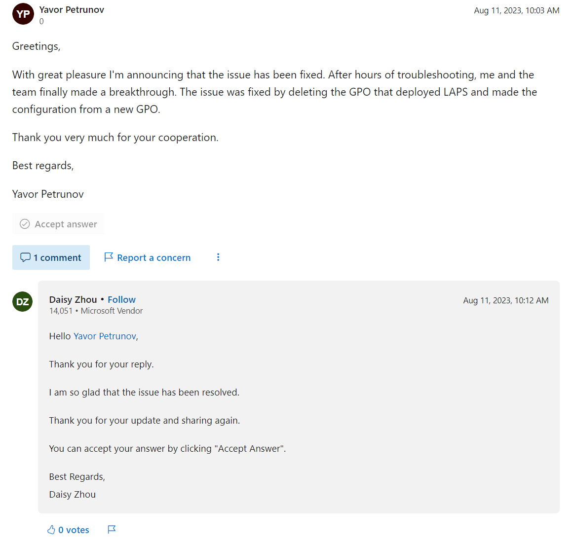

  3. Yavor Petrunov 20 Reputation points
    2023-08-11T07:03:31.2066667+00:00
    Greetings,
    With great pleasure I'm announcing that the issue has been fixed. After hours of troubleshooting, me and the team finally made a breakthrough. The issue was fixed by deleting the GPO that deployed LAPS and made the configuration from a new GPO.
    Thank you very much for your cooperation.
    Best regards,
    Yavor Petrunov

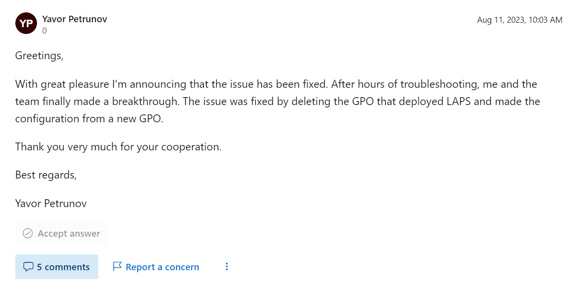

  4. Yavor Petrunov 20 Reputation points
    2023-08-11T07:41:45.8066667+00:00
    Greetings Daisy Zhou,
    I can click on "Accept Answer" under your answer User's image
    I don't know If I can "Accept Answer" on another post, because this is my first one. I tried signing in in incognito mode and tried restarting the browser as well. Still grayed out
