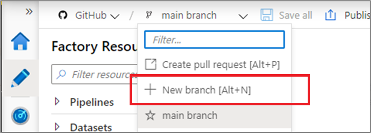

    Collaboration branch: Your Azure Repos collaboration branch that is used for publishing. By default, it's main. Change this setting in case you want to publish resources from another branch.
    Local branch: This is nothing but another/replication of the collaboration branch (main branch) with a different name.
    enter image description here
    Publish branch: The Publish branch is the branch in your repository where publishing related ARM templates are stored and updated. By default, it's adf_publish.
