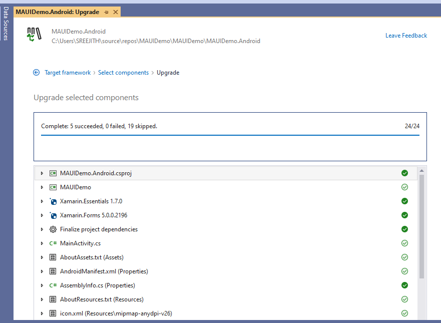

I have converted a Xamarin project to MAUI project using Upgrade Assistant as per this blog. First I upgraded solution, then I upgraded the android and ios projects. After that I build my solution but I get the below errors.

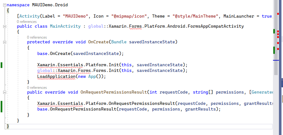

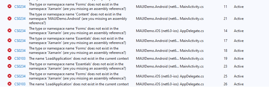

Error CS0234 The type or namespace name 'Forms' does not exist in the namespace 'Xamarin' (are you missing an assembly reference?) MAUIDemo.Android (net6.0-android) C:\Users\SREEJITH\source\repos\MAUIDemo\MAUIDemo\MAUIDemo.Android\MainActivity.cs 11 Active
Error CS0234 The type or namespace name 'Content' does not exist in the namespace 'MAUIDemo.Android' (are you missing an assembly reference?) MAUIDemo.Android (net6.0-android) C:\Users\SREEJITH\source\repos\MAUIDemo\MAUIDemo\MAUIDemo.Android\MainActivity.cs 21 Active
Error CS0234 The type or namespace name 'Essentials' does not exist in the namespace 'Xamarin' (are you missing an assembly reference?) MAUIDemo.Android (net6.0-android) C:\Users\SREEJITH\source\repos\MAUIDemo\MAUIDemo\MAUIDemo.Android\MainActivity.cs 17 Active
Error CS0234 The type or namespace name 'Forms' does not exist in the namespace 'Xamarin' (are you missing an assembly reference?) MAUIDemo.Android (net6.0-android) C:\Users\SREEJITH\source\repos\MAUIDemo\MAUIDemo\MAUIDemo.Android\MainActivity.cs 18 Active
Error CS0103 The name 'LoadApplication' does not exist in the current context MAUIDemo.Android (net6.0-android) C:\Users\SREEJITH\source\repos\MAUIDemo\MAUIDemo\MAUIDemo.Android\MainActivity.cs 19 Active
Error CS0234 The type or namespace name 'Essentials' does not exist in the namespace 'Xamarin' (are you missing an assembly reference?) MAUIDemo.Android (net6.0-android) C:\Users\SREEJITH\source\repos\MAUIDemo\MAUIDemo\MAUIDemo.Android\MainActivity.cs 23 Active
Screenshot:

  1. I upgraded the solution, android and iOS projects. Is solution upgrade is enough or do we need to upgrade the android and iOS projects?

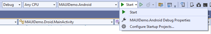

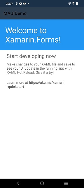

    But I can't run the app on my device bacause the device is not listing in debug section.
    But the device is available for all the other projects. Anything else to do to fix this issue?
    I added the <SingleProject>true</SingleProject> property into my Android project's .csproj file under the first/main property group, closed VS, deleted Bin, Obj, .vs folders.
    After starting VS again , I rebuilt and VS allowed me to debug on selected .net targets like a single project Maui solution.
    Then, you will get the AAPT error cannot find the mipmap/icon, please set all of files' build action to AndroidResource in the Resource folder.
    Then you can run your maui project.
