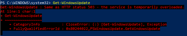

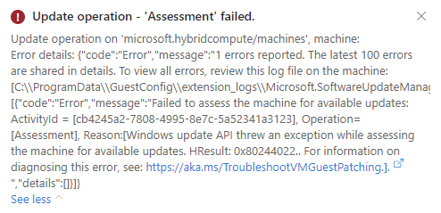

Recently added Arc-Enabled servers to the Update Management Center (Preview) and were working fine until a couple days ago. Suddenly, most of them could not get update data and returned error 0x80244022:
Now, the machines cannot even locally get update data. The machines are connected to the internet and otherwise functioning properly. The troubleshooter reports no issues and restarting the machine did not help.

    @Anonymous , based on the question, the error code 0x80244022 is similar to error 503 which means temporary overload (as also seen from PowerShell window output).
    This seems to be a transient error caused by temporary overload of the api endpoint and not something on the local machine level. Can you please check if you are still facing this issue? I assume that it would have been resolved by now.
