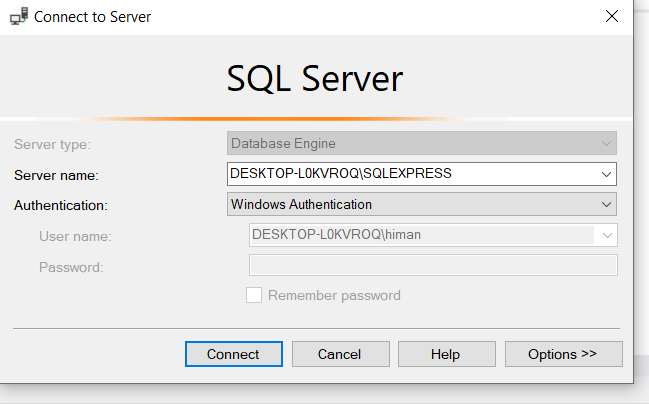

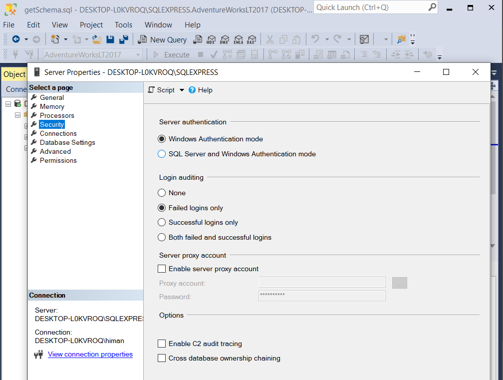

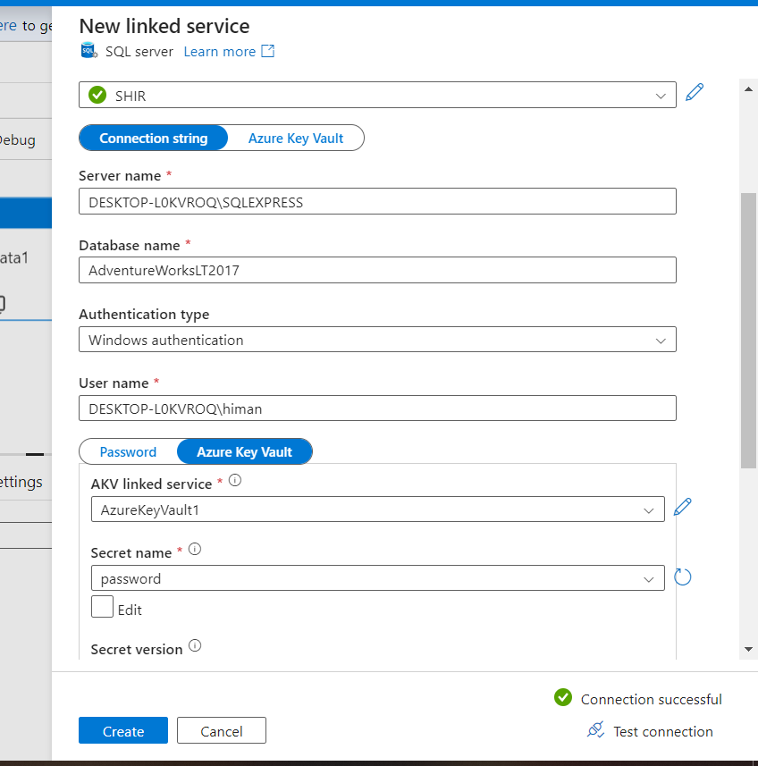

Hi i am getting below error while i try to connect adf to sql server using self hosted IR , i saw few pages which helps to whitelist the server but i am not sure where to do the changes ?
Cannot connect to SQL Database. Please contact SQL server team for further support. Server: 'DESKTOP-L0KVROQ\SQLEXPRESS', Database: 'AdventureWorksLT2017', User: 'test1'. Check the linked service configuration is correct, and make sure the SQL Database firewall allows the integration runtime to access.
Login failed for user 'test1'., SqlErrorNumber=18456,Class=14,State=1,
Activity ID: 51352b3b-7c08-44e5-a384-4df845df6ed0.

    So it was not a case of network issue :)
    Either SQL Auth is disabled on server or the credentials provided were wrong
