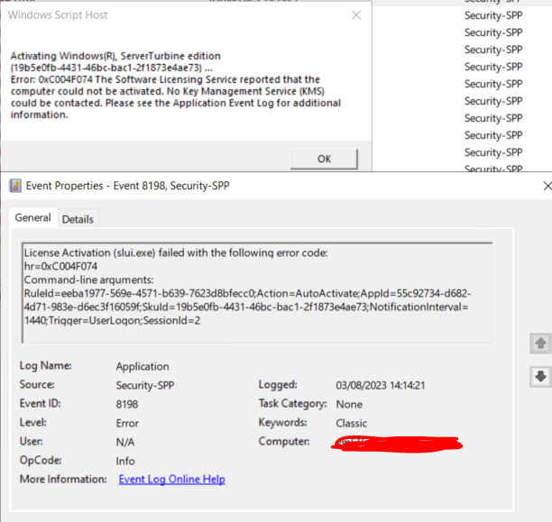

Hi, we have recently deployed 2 Win servers 2022 DC Azure edition and currently having Win activation issue. We have total 6 servers in this vNet and have the route table with kms.core.windows.net is enabled. The other 4 servers (same Win edition) didn't have any issue but these 2 servers cant get activated and when tried to setup the kms client and activation manually, they are throwing some error:activation error 01
Also, when try to test the net connection to kms.core.windows.net -port 1688, both ping and tcp test get failed. Also, we have allowed port 1688 in guest OS Win firewall but no joy. All other servers in this vNet and attached to the same NSG+route table are fine. Can we please get some advice to find out the root cause? Many thanks

    Hi Ghulam,
    As per Microsoft you will need to allow 2 additional IP addresses via the FW and check this blog for detailed steps - https://techcommunity.microsoft.com/t5/azure-compute-blog/azure-windows-virtual-machine-activation-two-new-kms-ip/ba-p/3621189

  2. Prrudram-MSFT 28,281 Reputation points Microsoft Employee Moderator
    2023-08-09T13:28:13.5866667+00:00
    Hello @Ghulam Abbas
    Activation issues can stem from a variety of factors. Let's go through some troubleshooting steps to help you identify and potentially resolve the root cause:
    Network Connectivity:
    • You mentioned that both ping and TCP tests to kms.core.windows.net on port 1688 are failing. This could be indicative of a network issue. Ensure that outbound internet connectivity is allowed for these instances.
    • Check if there are any network security group (NSG) rules or Azure Firewall rules that might be blocking outbound traffic on port 1688. Make sure that the instances can reach external servers, especially the KMS server.
    • Verify that the route table associated with the subnet containing these instances is correctly configured to route traffic to the internet.
    Firewall Settings:
    • You mentioned that you've allowed port 1688 in the Windows Firewall. Double-check that the rule is correctly configured and applied to both the domain and private profiles.
    • If there's a network-level firewall within your organization, make sure it's not blocking traffic to the KMS server.
    DNS Resolution:
    • Ensure that the instances can resolve the DNS name kms.core.windows.net. Incorrect DNS resolution could lead to connectivity issues.
    Time Synchronization:
    • KMS activation relies on accurate time synchronization. Ensure that the system time on the affected servers is correct and synchronized with a reliable time source.
    Proxy Configuration:
    • If you're using a proxy server to access the internet, make sure that the proxy configuration on the affected servers is correctly set up.
    Azure Route Table and Network Configuration:
    • Verify that the route table associated with the subnet is correctly configured to route traffic to the Azure KMS server.
    • Check the network configuration of the instances, including subnet associations, route tables, and network security groups, to ensure they match the working servers.
    Azure Resource Health and Service Issues:
    • Check Azure Resource Health and Service Health to see if there are any ongoing issues in the Azure region that could be affecting activation or network connectivity.
    Azure Support:
    • If the issue persists, consider reaching out to Azure support for more personalized assistance. They can provide insights into the specific Azure environment and help troubleshoot the issue.
    Remember that diagnosing activation and connectivity issues can sometimes be complex due to the interaction of multiple factors. It's recommended to systematically go through each potential cause, checking and validating the configuration at each step.
