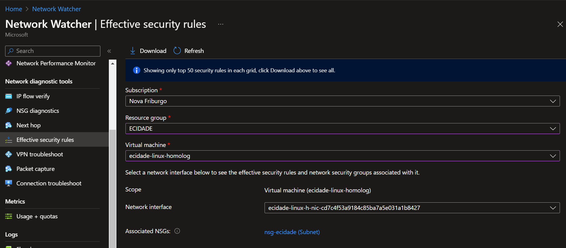

    If the service is running locally, make sure there isn't a conflict in the Network Security Group rules, usually the NSG is bound only on the VNET, but there are cases that you bind on both the VNET and the NIC, if you have two nsgs, make sure that the inbound rule is currently configured on both
    You can go to Network Watcher -> Effective security rules - to verify which NSG are associated with your VM
    just like:

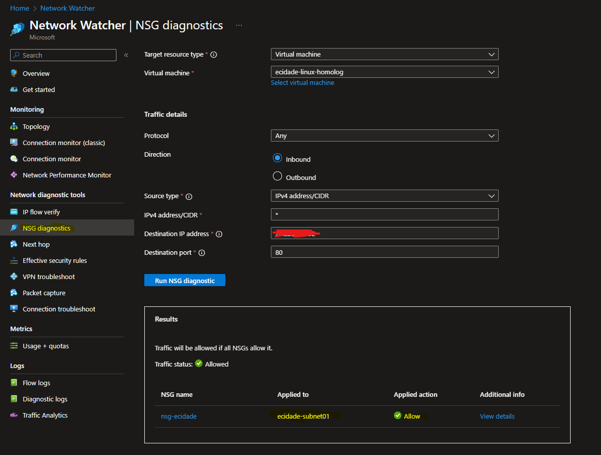

    You can also run "NSG Diagnostics" to verify if there are any deny rule, just like:
