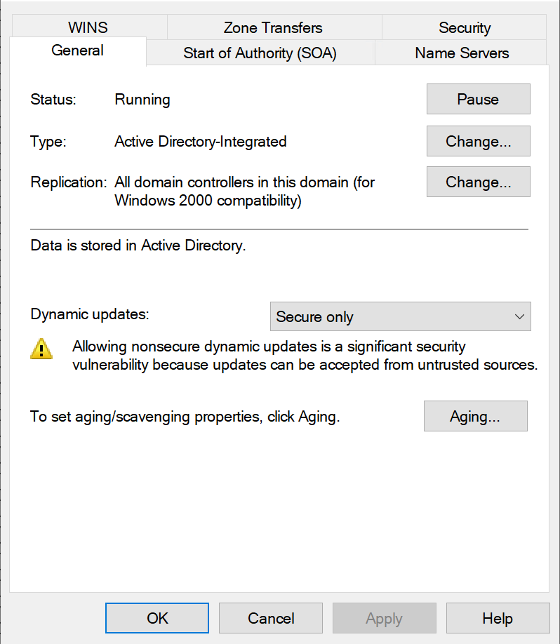

We have a DNS server (domain controller), and another DHCP server.
Followed https://learn.microsoft.com/en-us/previous-versions/windows/it-pro/windows-2000-server/cc959284(v=technet.10) to configure a dynamic update on DHCP server, which means DNS and DHCP integration.
  1. The DHCP server was added to DNSupdateProxy group.
  2. The DNS server was configured to securely dynamic update only.

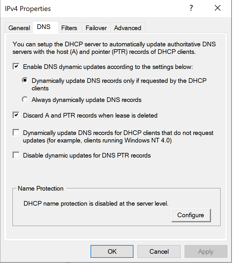

  1. The DHCP server was configured to "Dynamic Update only if requested by the client", and "Discard A record when lease expired", no "name protection".

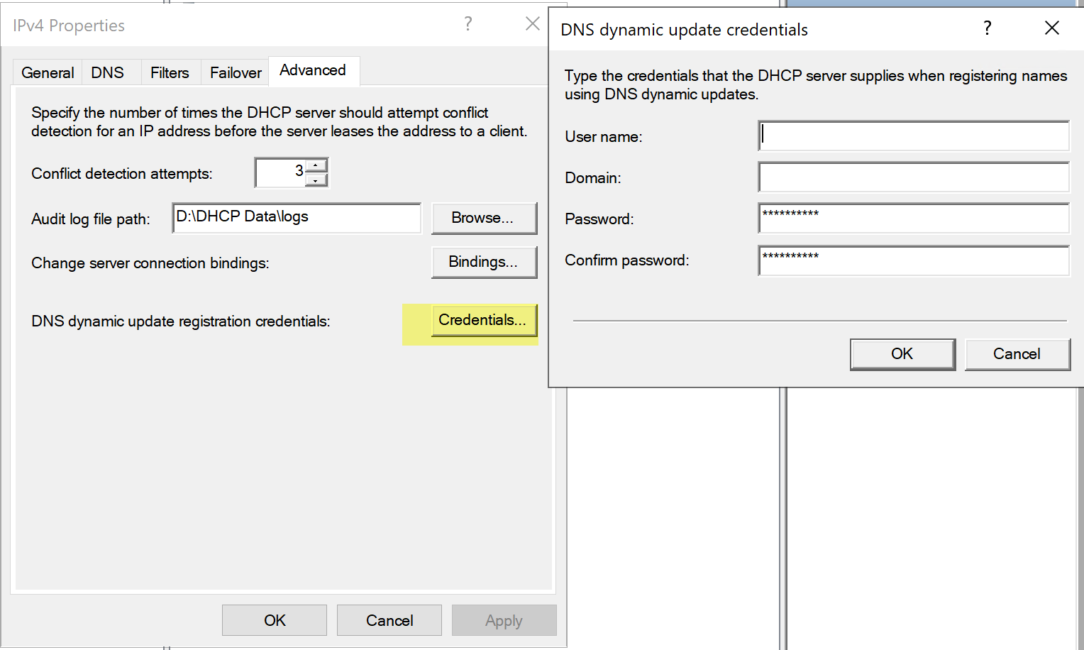

I just find that the below credential isn't configured. (not sure why)

    DHCP Server Configuration:
    Double-check the DHCP server configuration to ensure that it's set up correctly for DDNS. The settings you mentioned ("Dynamic Update only if requested by the client" and "Discard A record when lease expired") are generally appropriate for typical DDNS scenarios.
    Credentials for DNS Updates:
    As you mentioned, the credentials for DNS updates might not be configured. Configure these credentials in the DHCP server settings. They are used for updating DNS records on the DNS server. Use a user account that has the necessary permissions to update DNS records.
