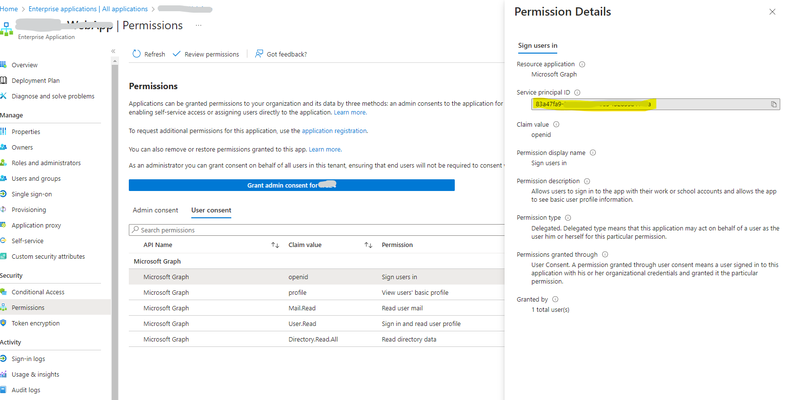

    To get the objectId of the user, run Get-AzureADOAuth2PermissionGrant powerShell command to retrieve objectId, resourceID and scope assigned.image
    Here resourceId is the service Principal ID which you can match with the permission you want to remove.
    Match the service Principal Id with the resource Id and copy the corresponding objectId from the above.
    You can then remove the permissions using
    Remove-AzureADOAuth2PermissionGrant -ObjectId SLC0E57-xxxxxx-xxxxxx
    which will remove the permission.
