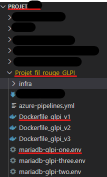

The path of my Dockerfile_glpi_v1 (I use VS Code to push it to GitHub) is : Projet > Projet_fil_rouge_GLPI There are several dockerfiles and .env file because I wish to deploy several versions of GLPI but I start with only one first.
2023-08-08-16h37_tree
Could you please enlighten me ? I apologize if this is because of my inexperience or a mistake on my part.
