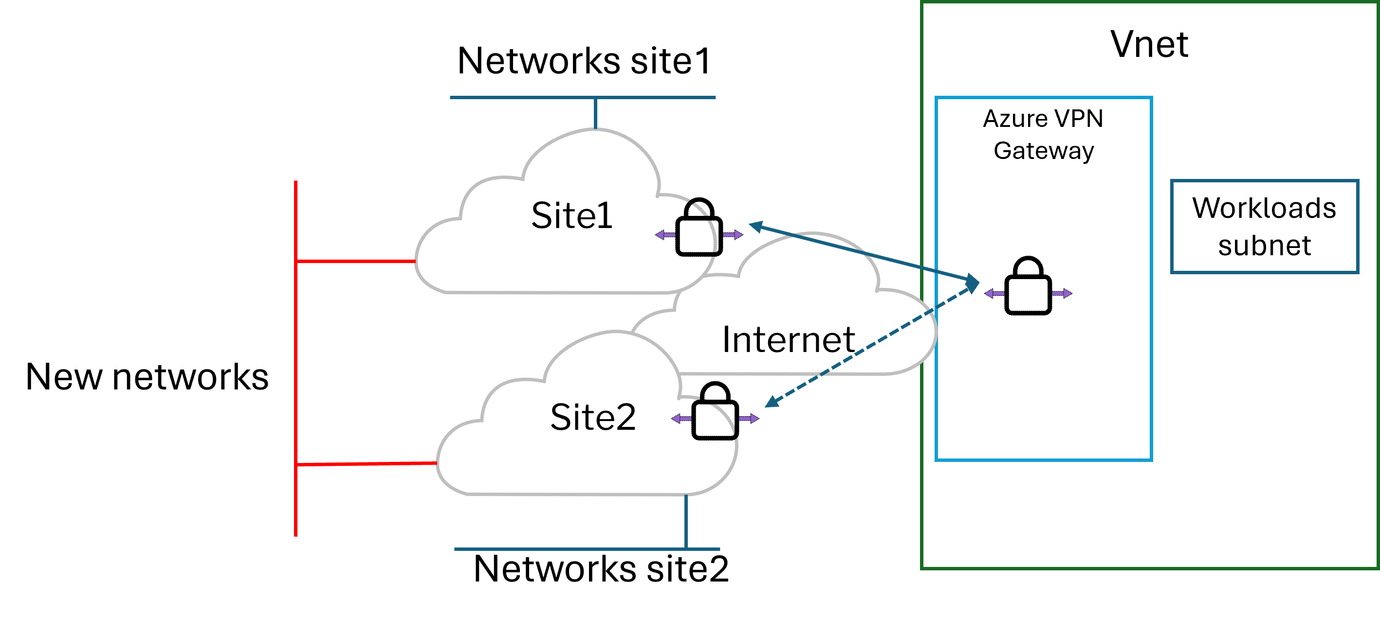

I have set up a S2S connection in Azure with a route based Virtual Network Gateway (VPN) connected to two Local Network Gateways (On premise).
I have configured the same static routes on both LGWs.
So there are two connections
VPN -> Connection 1 --> Primary LGW
VPN -> Connection 2 --> Secondary LGW

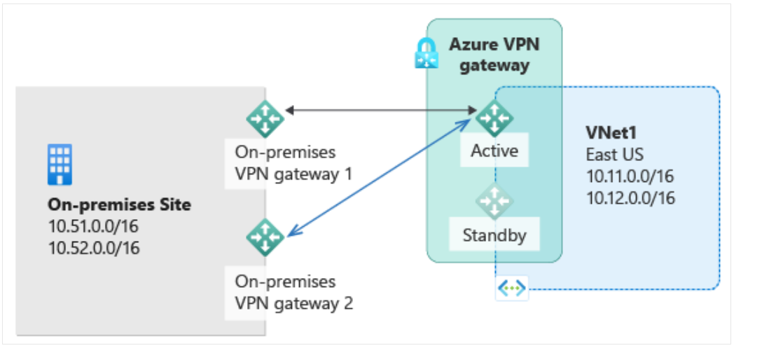

I was after an active-passive like this (but without the BGP requirement) as outlined here: https://learn.microsoft.com/en-us/azure/vpn-gateway/vpn-gateway-highlyavailable
I would of thought that only one connection would be up and the other would be down. Both are coming up and showing as "Connected" at the same time. Is that expected and ok?
Thanks for helping me it's been quite a learning experience

    I understand that you've up a S2S connection in Azure with a route based Virtual Network Gateway (VPN) connected to two Local Network Gateways (On premise) with the same static routes on both LGWs and both connections are showing as "Connected" at the same time. You would like to know if this is expected.
    Previously, it was not possible to create VPN connections with overlapping address ranges and it used to fail but this changed when VPN gateway started supporting NAT, and now you can create 2 connections with different LNG IP addresses and same address ranges on the same VPN gateway and both will show connected.
    But due to the overlapping address ranges, only one connection is used at a specific moment in time (even if both tunnels are UP at MM level) as the VPN gateway will only install one NEXT HOP for STATIC Routes for the on-prem ranges in its routing table.
    So, this setup is still active-standby and only one connection will work at one time.

    You should use BGP in such setups as mentioned in the below doc:
    https://learn.microsoft.com/en-us/azure/vpn-gateway/vpn-gateway-highlyavailable#multiple-on-premises-vpn-devices
