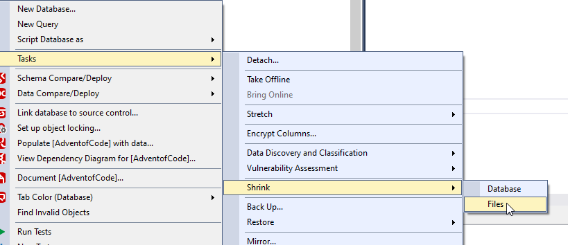

    It would be good to know what you tried. If you clicked Shrink Database in SSMS, this uses SHRINKDATABASe, as Alberto noted.
    You can instead click the files option, shown here:
    2023-08-09 10_48_08-travelqueries.sql - ARISTOTLE_SQL2022.way0utwest_dev (ARISTOTLE_Steve (53))_ - M

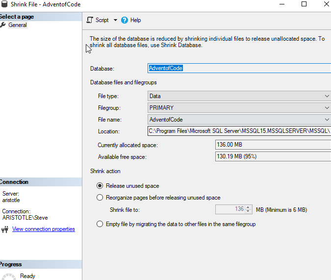

    Once you've done that, you can fill out the dialog, as per your specs.
    2023-08-09 10_48_21-Shrink File - AdventofCode
