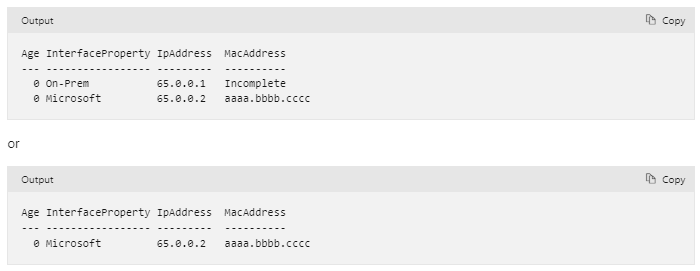

    If a problem with the on-premises or connectivity provider occurs, the ARP table shows one of two things. You see the on-premises MAC address show incomplete or only see the Microsoft entry in the ARP table. As shown belowUser's image
