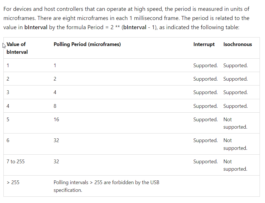

Hello, I need to change bInterval from 1ms to 4ms, I believe it will lower pressure on the system. If USB interrupts will occur not every 1ms, but 4ms.
https://learn.microsoft.com/en-us/windows-hardware/drivers/ddi/usbspec/ns-usbspec-_usb_endpoint_descriptor - I read here I need to change bInterval from 4 to 32. And Transfer type from isochronous to interrupt. I think I changed that and tested with this https://www.thesycon.de/eng/usb_descriptordumper.shtml
I tried these settings:

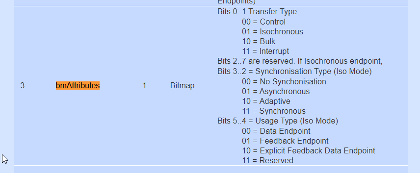

bmAttributes 0b0011
wMaxPacketSize 482ch2bytes*4ms= 768 bytes
bInterval 0x6 = 2^(6-1) microframes = 32 * 125us = 4000us
	/* ------------------------- Endpoint Descriptor */
	/* [242] 0 bLength, bDescriptorType */ 7, 0x05,
	/* [244] 2 bEndpointAddress */ 0x83,
	/* [245] 3 bmAttributes : 0x0D (Sync|ISO) */ 0x03,
	/* [246] 4 wMaxPacketSize : 0xC0 (48kHz * 2 channels * 2 bytes width) */ 0x00, 0x03,
	/* [248] 6 bInterval : 0x04 (1ms) */ 0x6,

  1. Chaoqiong Xiao 486 Reputation points Microsoft Employee
    2023-09-05T03:11:26.02+00:00
    @Serhii Cherkasov The data endpoint for USB Audio must be isochronous endpoint, interrupt endpoint does not work.
