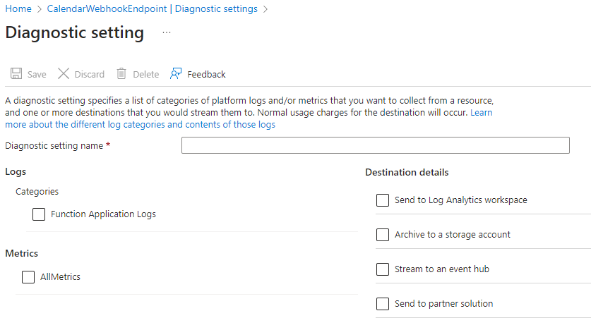

    Also, Sometimes, logs visible in the Azure portal (especially through the monitor blade) are stored in a different location than those accessed via the az webapp log download command. The command is designed to download logs from the file system, but the portal may also display logs stored in other services like Application Insights. Ensure that your function's logs aren't being stored or streamed to a different location.
    this is a bit complex to determine, however, here is how you can do it:
    Identify the Storage Location:
    • Open the Azure portal & Navigate to your Azure Function.
      • Under the Monitoring section, click on "Diagnostic settings" or "Diagnostic logs". This should show you where your logs are being sent to. Common destinations include Application Insights, Azure Blob Storage, Azure Monitor Logs, etc.

    Adjust Diagnostic Settings:
    • If you wish for your logs to also be stored in the file system for easy access via az webapp log download:
      • Navigate to the Azure Function's Diagnostic settings.
        • Adjust the destination to include Filesystem, ensuring that the correct log level and category are set.
