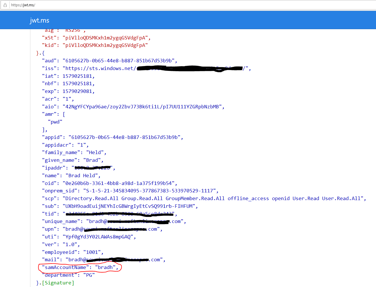

    1. Next you can use the Authorization Code flow of OAuth2.0 and request for a code from AAD.
    2. Once you have the code, use the code to request for an access token from AAD for the above app on whose ServicePrincipal the AzureADPolicy was added. [I used POSTMAN tool to test the same]
      alt text
      1. Once you get the Access Token use https://jwt.ms to see the decoded JWT and you should see the SamAccountName listed in it as claims.
        alt text  you can add the onPremisesSamAccount name to the claims and send it within an access token. You can follow the steps mentioned below:
                                                                   1. Once you have the code, use the code to request for an access token from AAD for the above app on whose ServicePrincipal the AzureADPolicy was added. [I used POSTMAN tool to test the same]
                                                                                                                                        ![alt text](https://learn-attachment.microsoft.com/api/attachments/1981-postmansnip.png?platform=QnA)
                                                                               1. Once you get the Access Token use [https://jwt.ms](https://jwt.ms/) to see the decoded JWT and you should see the **SamAccountName** listed in it as claims.
                                                                                                                                                                ![alt text](https://learn-attachment.microsoft.com/api/attachments/1971-claims.png?platform=QnA)
          Let me know if you have any further questions on this.
