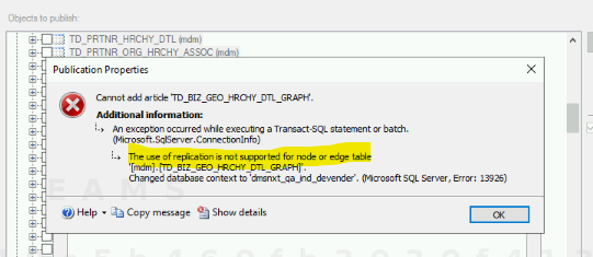

    2023-08-14T05:28:13.6466667+00:00
    Hi @Mukesh Ojha
    Yes, as Erland said, I also didn't find clear documentation stating SQL server native replication tool support graph table replication. The official documentation only says that the graphics extension is fully integrated into the SQL Server database engine.
    Screenshot 2023-08-14 132641
    For more details, you can refer to this link: https://learn.microsoft.com/en-us/sql/relational-databases/graphs/sql-graph-overview?view=sql-server-ver16.
