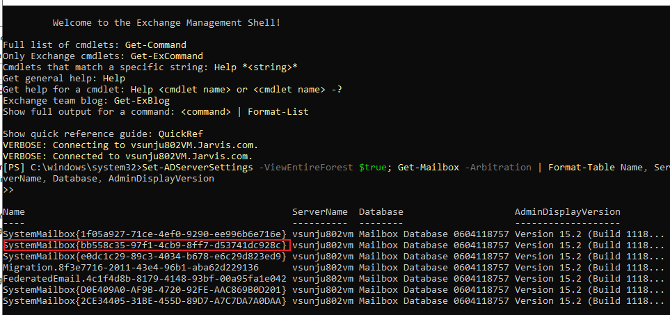

    1.Use the below cmdlet to check if there is the specific missing arbitration mailboxes in our Exchange organization.
    Set-ADServerSettings -ViewEntireForest $true; Get-Mailbox -Arbitration | Format-Table Name, ServerName, Database, AdminDisplayVersion

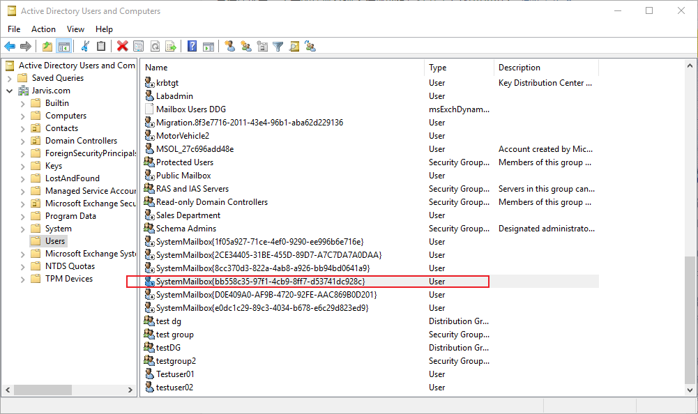

    2.Check Exchange arbitration mailboxes in Active Directory Users and Computers. If it is not present there, then try to recreate the object. https://www.alitajran.com/recreate-arbitration-mailboxes-in-exchange-server/User's image
