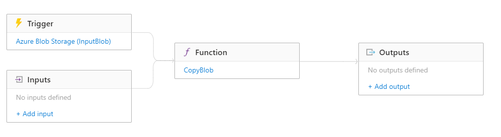

I'm having a heck of a time here, and I've followed the MS instructions to no avail. It's really simple what I want to do. When a blob is written to a container named "test", I want a PowerShell function to execute. The PowerShell function needs to only know the name of the blob created (in this case I'm testing with a file name "test1.csv"). When the test/test1.csv blob is created, the PowerShell is going to grab it and do some work with it, then it will end up writing a file to another container in the same storage account (not really the problem right now though). What in the world am I doing wrong? Can someone walk me through this? I've create a consumption-based function with the PowerShell stack, but I can't get anything to work, the Powershell script just doesn't seem to get executed.

    If the issue is that your trigger isn't firing at all, I would carefully review the table in the following doc & make sure that a correct configuration is being used against a matching storage account version: Trigger on a blob container. Although when working with blobs, the general rule of thumb is to use event-based triggers if possible.
    If all that needs to be accomplished for now is a copy operation between containers in the same storage account, I think that your code & config can be much simpler as shown in the following example: https://learn.microsoft.com/en-us/azure/azure-functions/functions-bindings-storage-blob-output?tabs=python-v2%2Cin-process&pivots=programming-language-powershell#example
    You might also try using Set-AzStorageBlobContent instead of the Start-AzureStorageBlobCopy cmdlet.
    If the issue still persists despite validating config against a correct storage account and simpler code based on the above, let me know and I'll help troubleshoot as the root cause may likely be within your unique environment.
