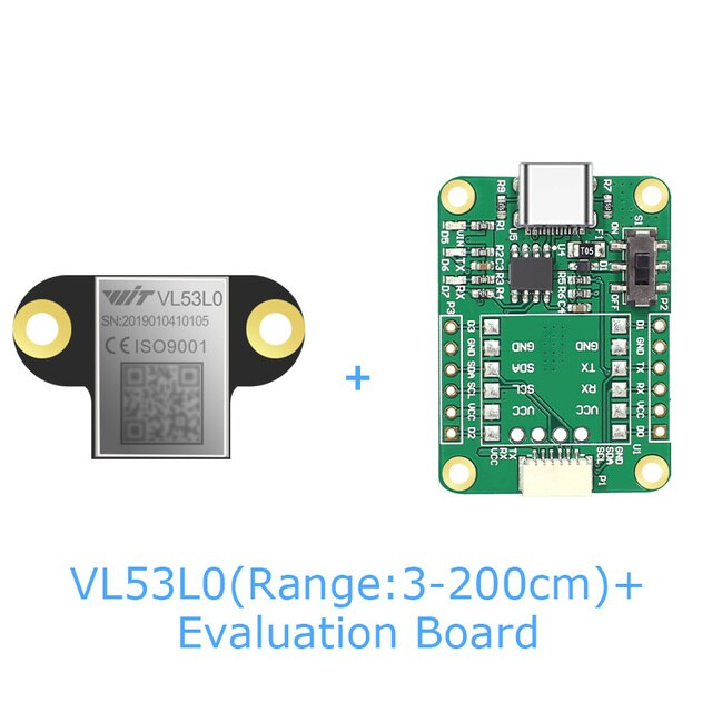

    Hello @Вадим Белых ,
    based on your comments, you are using a USB version of this sensor.
    I found this community library with samples:
    Vl53L0X vL53L0X = new Vl53L0X(I2cDevice.Create(new I2cConnectionSettings(1, Vl53L0X.DefaultI2cAddress)));
    Console.WriteLine($"Rev: {vL53L0X.Information.Revision}, Prod: {vL53L0X.Information.ProductId}, Mod: {vL53L0X.Information.ModuleId}");
    This sensor will probably be used with a constrained device like an Arduino.
    Because it has an I2C bus connection, it can be used on a Raspberry PI too.
    There are libraries and code samples available as seen here.

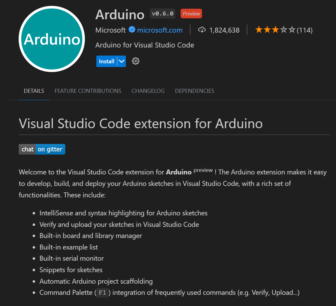

    Most of the documentation will point you to the Arduino IDE which is ok.
    For Visual Studio code, an extension is available:
    So you probably code on an RPI or you have an Arduino (or eg. ESP32) connected and deploy your code to that device.
