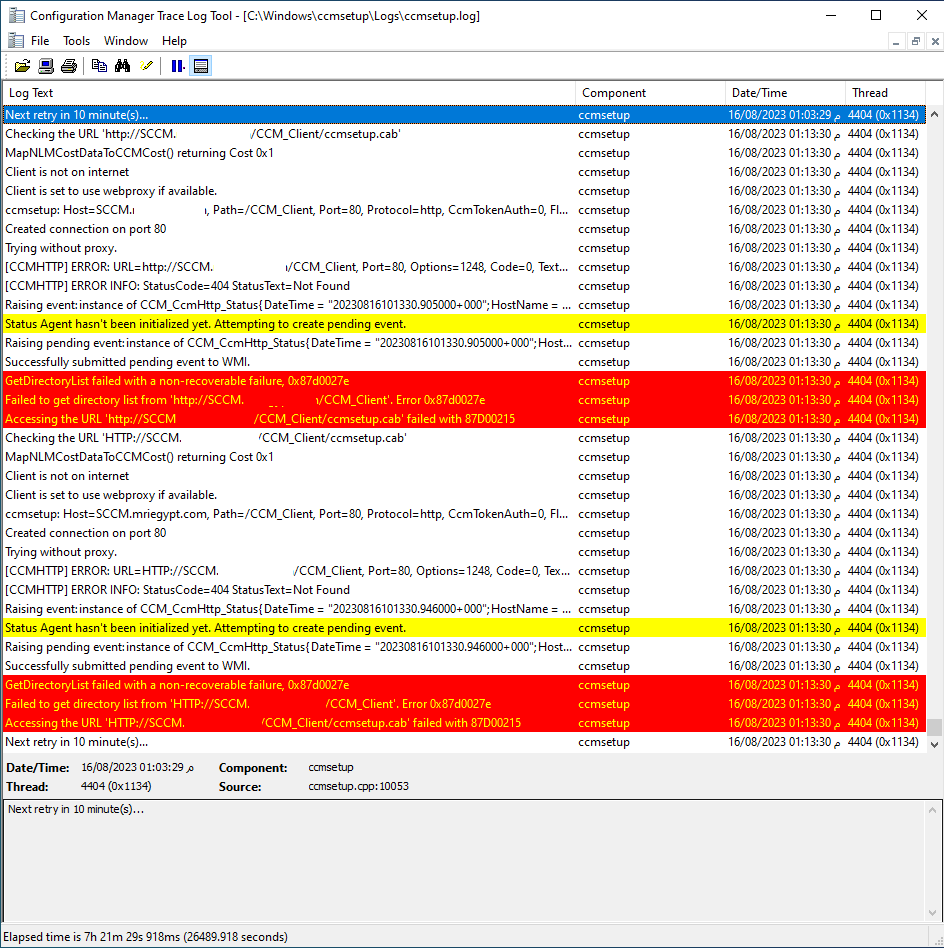

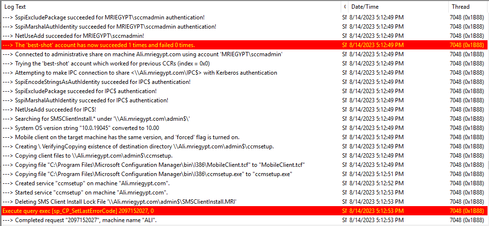

I can't Install SCCM Agent using Client Push Installation As Shown
Untitled

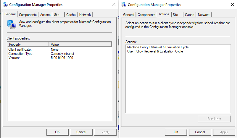

So I tried To Install The Agent Manually And it's installed With Code 0 As Shown
2
But It's Not Connected With SCCM Server And In Control Panel As Shown
3

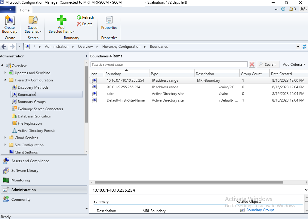

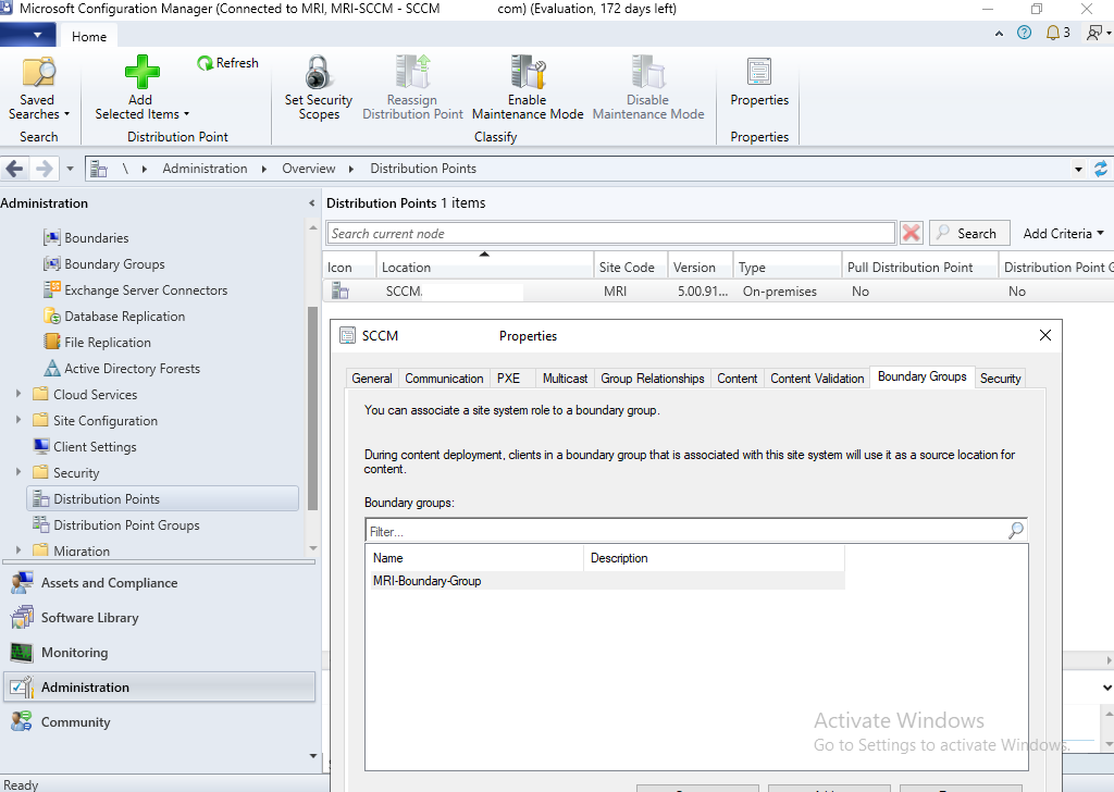

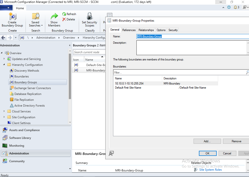

    Based on the ccmsetup log shared above, you have to double check your boundaries and boundary groups then run a manual install with setting the necessary parameters.
    You can refer to my following blog post to create a boundary as an IP address range related to your clients then assign the DP/MP to the boundary group:
