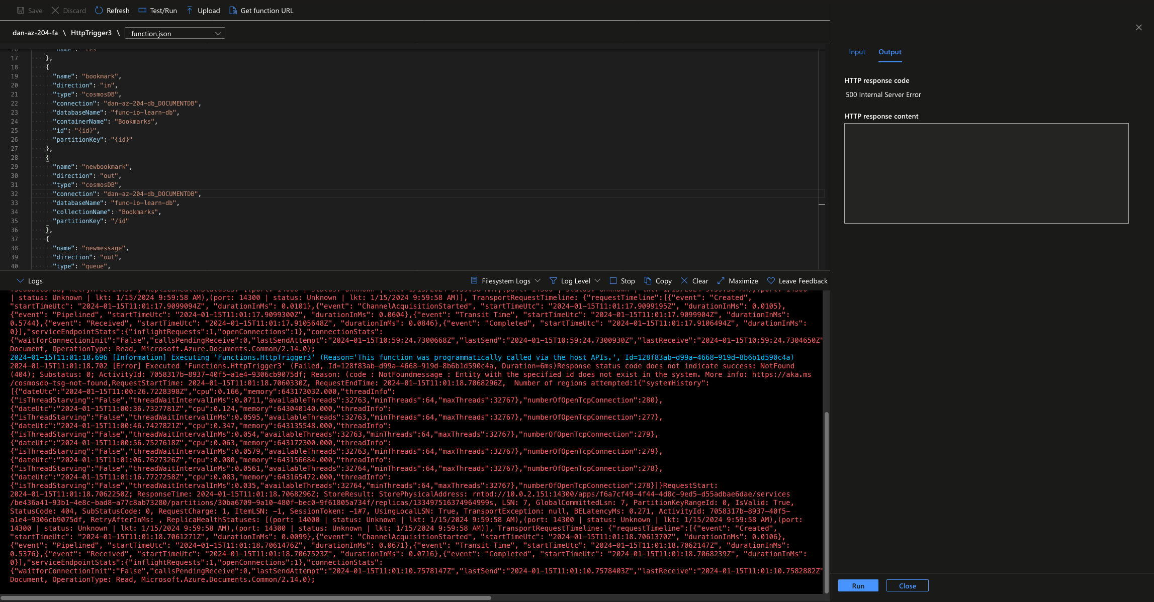

  4. humaira siddiqui 0 Reputation points
    2024-02-03T19:31:43.22+00:00
    I am also facing the same issue.. I have added logs to trace the cause - the function is not going in else statement, it seems the exception is raised from cosmos db. Not able to figure out a solution. Any help is appreciated User's image
