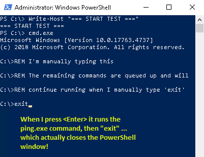

But I've recently encountered some environments where execution "halts" after cmd.exe, and only continues once I've manually exited the command prompt:
Is this a behavior I have control over? How to I make the second environment behave like the first one?

  2. MotoX80 37,161 Reputation points
    2023-08-16T13:09:48.5366667+00:00
    And PowerShell will dutifully execute each command at each prompt:
    When you execute them one by one, cmd.exe sees the ping statement by reading from stdin. (The "at each prompt".)
    When you paste the statements, Powershell.exe has to make Windows API calls to read the pasted data from the clipboard.
    https://learn.microsoft.com/en-us/windows/win32/dataxchg/clipboard-operations#paste-operations
    At this point Powershell has the 5 lines and can begin execution. It executes the write-host and launches cmd.exe. The "problem", as I see it, is that Powershell has no way to know that the next 2 lines (ping/exit) are intended for cmd.exe and need to be copied from the clipboard buffer and redirected to stdin (as part of launching cmd.exe). Or put back into the clipboard in a way that cmd.exe can recognize that it has data that it needs to read and process.
    You can have Powershell pass your commands via stdin or build a file and pass that as a parameter.
    Write-Host "=== START TEST ==="
    $crlf = "`r`n"
    $cmds = "@echo Hello from Cmd" + $crlf
    $cmds += "ping localhost -n 1" + $crlf
    $cmds += "@echo Goodbye from Cmd"  + $crlf
    $cmds | cmd.exe
    Write-Host "=== SECOND TEST ==="
    $tmp = $env:TEMP + "\temp.bat"
    $cmds | Out-File $tmp  -Encoding ascii
    cmd.exe /c $tmp
    Write-Host "=== END TEST ==="
