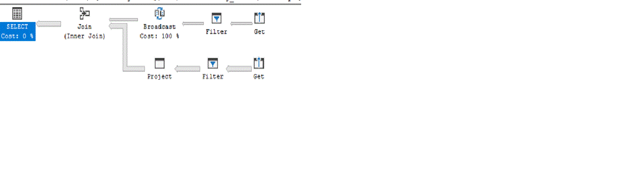

I ran the same query in both tables. In partitioned table I use the partitioned column as a filter (WHERE clause). Unfortunately, there is no improvement in the execution time in the query with partitioned table. The execution time in both queries was the same.
 Also, I have tried to create a new workload group (wgUserQueries), with more resources to handle the queries, but that didn't make any difference either. I have advised best practices for partitioning tables and tuning queries. I have tried different combinations for indexes (clustered and non-clustered) but the issue still exists. In the execution plan, there is a 100% cost in the BroadcastMoveOperation."
Please advise what is happening and why there is no improvement after switching to partition table and what else should I consider?
