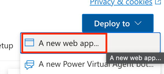

I was able to deploy a gpt-35-turbo model via https://oai.azure.com/ with custom data and in the chat playground it works perfectly. If I do an Azure Web App deploy, it also works perfectly.

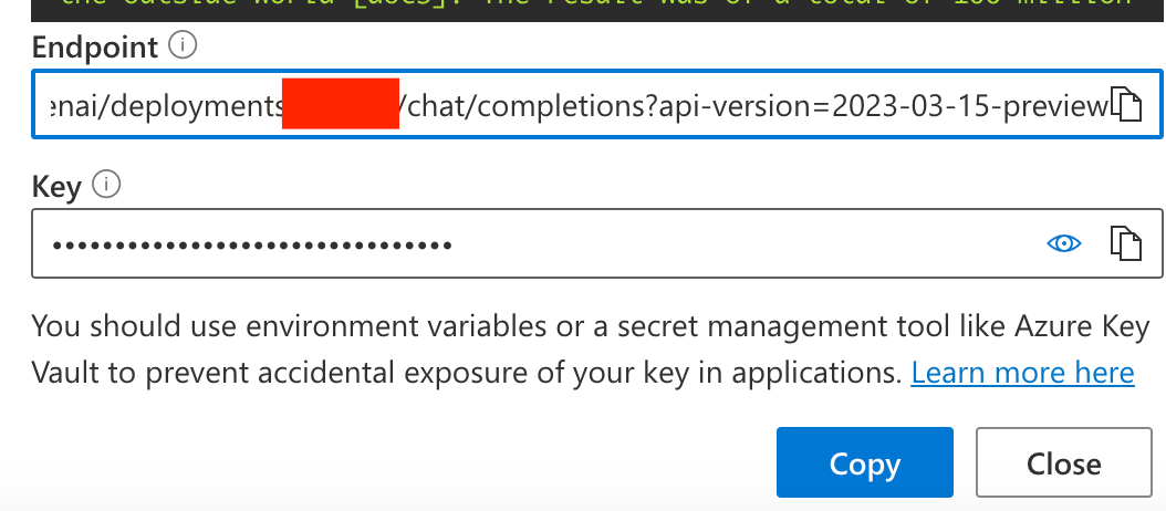

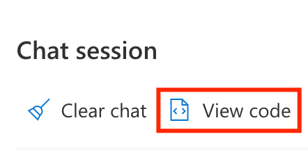

I try to get the info from here:
Which shows me the url for the API and the KEY:
When I try to call this endpoint, it returns a complete hallucination for a given question - as if it would not take the custom data into account.
This is really strange, as the chat playground takes the custom data into account, and replies accordingly.
