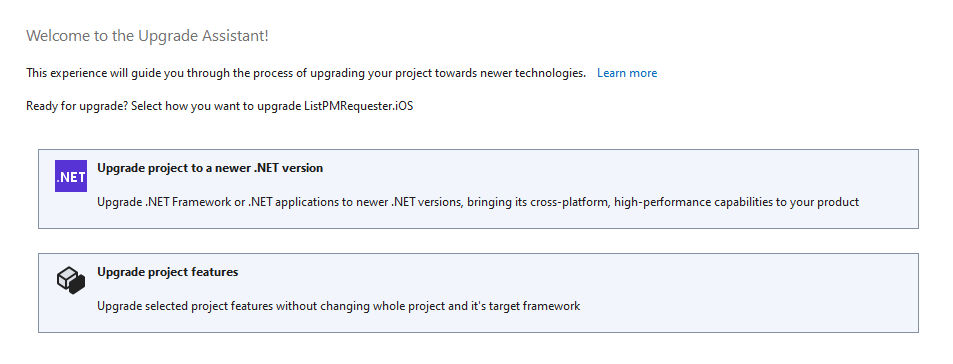

I have tried to migrate my Xamarin Forms app to MAUI using .NET 7 using the upgrade assistant extension in visual studio. First I migrated the solution, then android and finally the iOS projects. (Is this workflow correct?)
After that I have deleted the bin and obj folders, clean the project and done Rebuild.

    After testing, xamarin.ios projects that cannot find the target framework after upgrading using the latest upgrade assistant will have the problem of not finding the target framework.

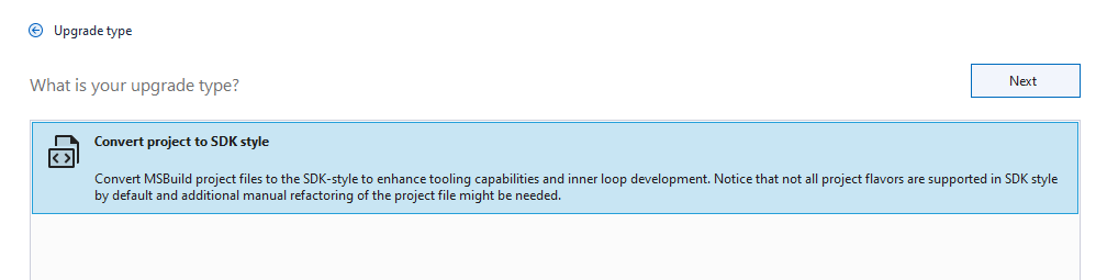

    So my doubt is before upgrading Do I need to Convert project to SDK style? I feel some of the issues are happening due to some kind of cache. Do I need to clear any kind of folders like bin and obj? Other than bin and obj, do I need to delete any other cache folders for the proper working of the application?
    You need to change the SDK style, and the issue is not caused by cache. Upgrade Assistant does not complete all the migration work, you need to refer to the following documents to complete the manual migration.
    Run .NET Upgrade Assistant for .NET MAUI to migrate your csproj to SDK Style, and perform well-known code migration (namespaces, name changes)
