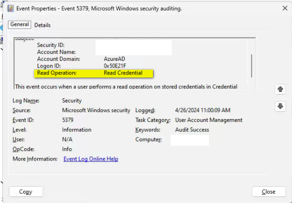

    Looking at Event Log ID 5379 I realized the computer that can access the server using AzureAD says Read Credentials:User's image

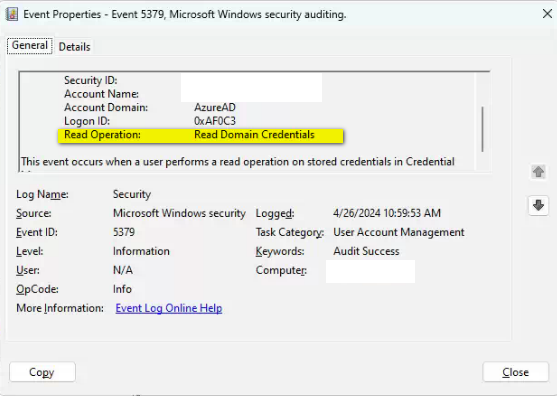

    Whereas the computer that was not able to access the computer said Read Domain Credentials:User's image
    I looked into credentials manager the the computer that was not able to access the server had credentials saved. I deleted those and it started working.
