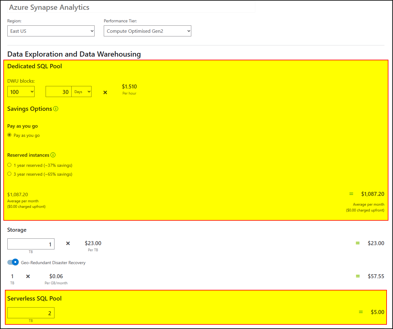

  1. Das, Mahasweta 20 Reputation points
    2023-08-24T05:14:09.6933333+00:00
    Dear Annu,
    Thanks for your answer.
    Yes it helped me, but could you please give me the cost calculation for serverless vs dedicated please?
    Thanks,
