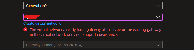

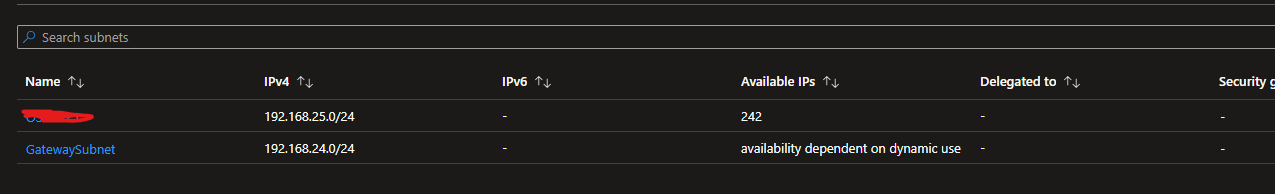

I am in process of creating a VNGW , but I am getting the below error. I have 2 subnets under this Virtual network like below.

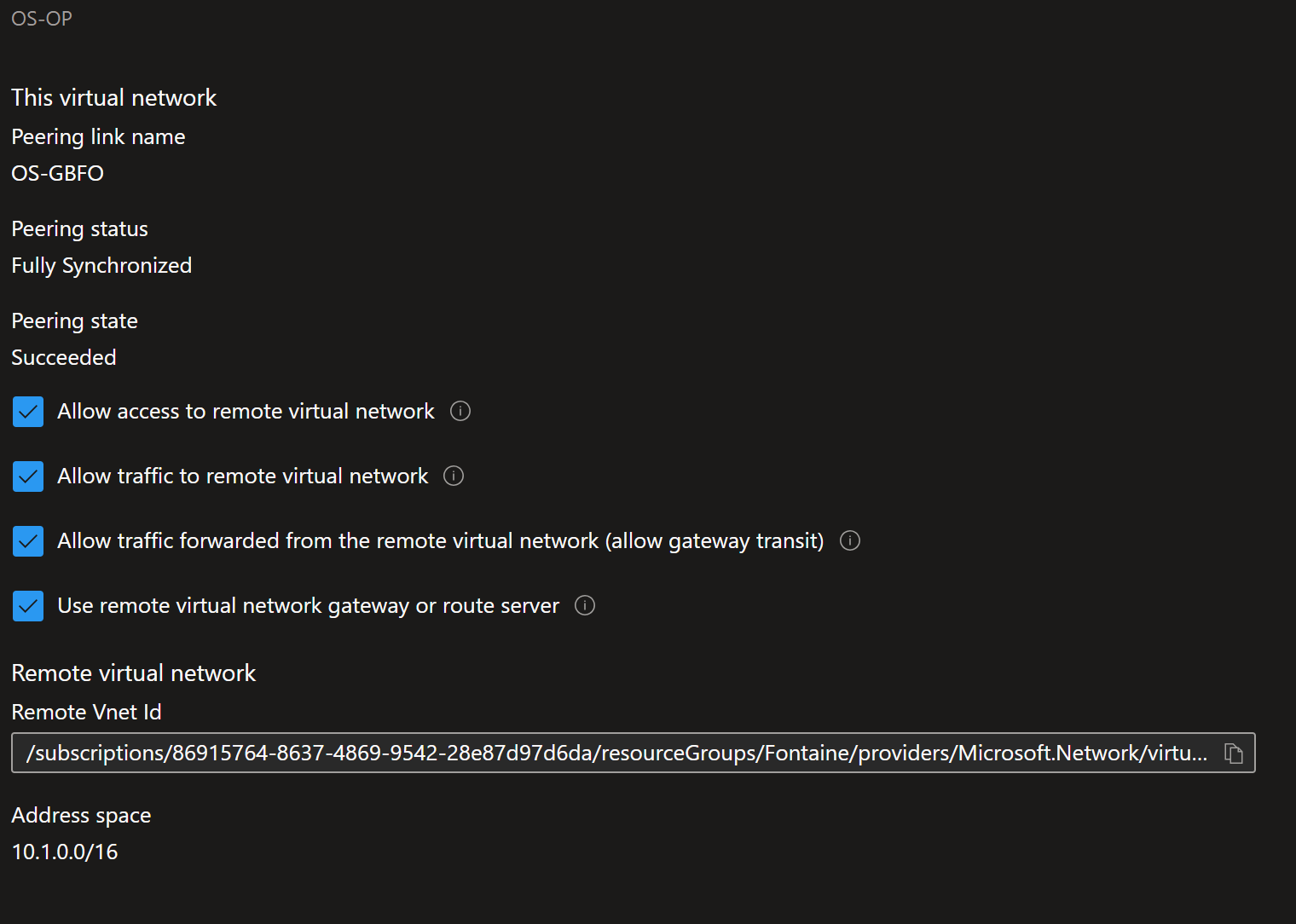

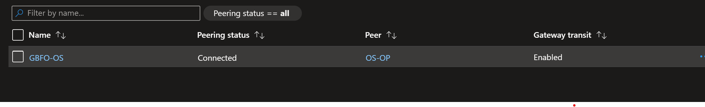

the back story of what I'm trying to achieve is have one VPN client that the end user can use to connect to machines on multiple vnets. So the idea is to create 2 VNGW and create connections between the 2 so that this should allow this. Rather than having 2 VPNs that the client needs to run. I have tried having just the one VPN gateway with VNET peering between the two VNETs as I thought this would originally work , but it hasnt hence the reason why im going down this route.

    Based on the error observed in the screenshot above. In an Azure Virtual Network, you can deploy only one VPN gateway, this is documented here. You are getting the error above when you are trying to add another VPN Gateway to the virtual network which already has a VPN Gateway.
    This is actually a recommended way to achieve the required communication. A similar scenario is described here.
    You need to set the following configuration on your peered Vnets.
    • Configure the peering connection to Allow gateway transit.
    • Configure the peering connection to Use the remote virtual network's gateway.
    You can also refer to this tutorial if you have hub and spoke architecture for your vnets.
