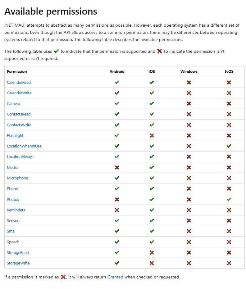

liu • 0 Reputation points
2023-08-21T09:31:17.3066667+00:00 Here are some of the Microsoft documents I looked through.
Wenyan Zhang (Shanghai Wicresoft Co,.Ltd.) • 36,436 Reputation points • Microsoft External Staff
2023-08-21T09:48:25.26+00:00 For example: if you want to add the
Camera
permission, you could open theAndroidMainfest.xml
file, then drop down to Required permissions section, and selectCAMERA
. (Or open theAndroidMainfest.xml
file with Source code, then add<uses-permission android:name="android.permission.CAMERA" />

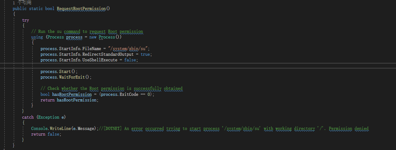

2023-08-24T01:03:23.1733333+00:00 In this method, I start a process that accesses "/system/xbin/su" to get ROOT permission. Finally, a bool value is returned to determine whether the permission was successfully obtained.However, when the code path executes the Start0 method, an error is printed
2023-08-24T01:05:31.26+00:00 The error is as follows, and it tells me that I do not have permission to access this path

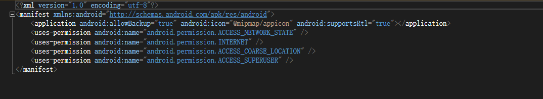

2023-08-24T01:07:43.0366667+00:00 This is my "AndroidManifest.xml" configurati,How should I face this problem?
2023-08-24T08:45:42.2666667+00:00 I start a process that accesses "/system/xbin/su" to get ROOT permission.
Above way actually result that processes can be run as root, not your MAUI applications themselves.
Without root permission, your application cannot access it.
