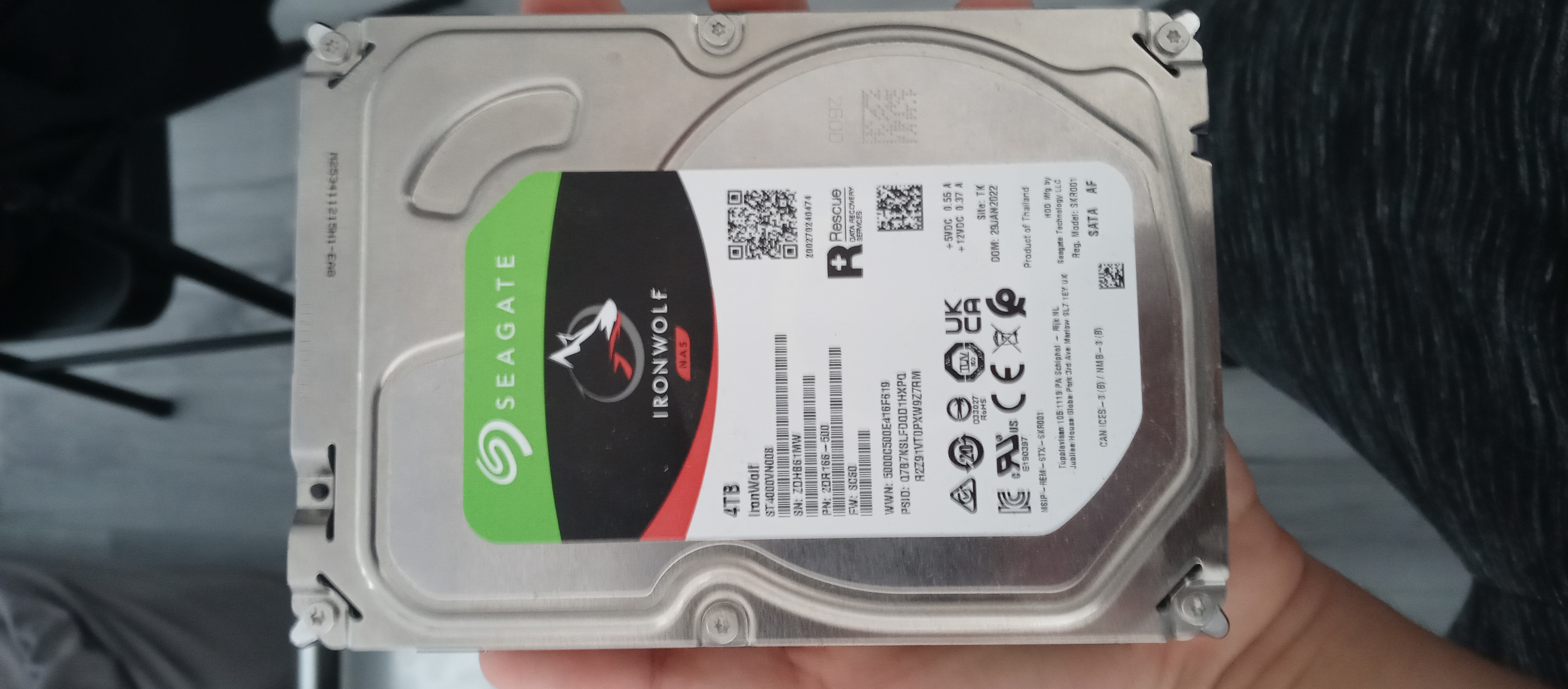

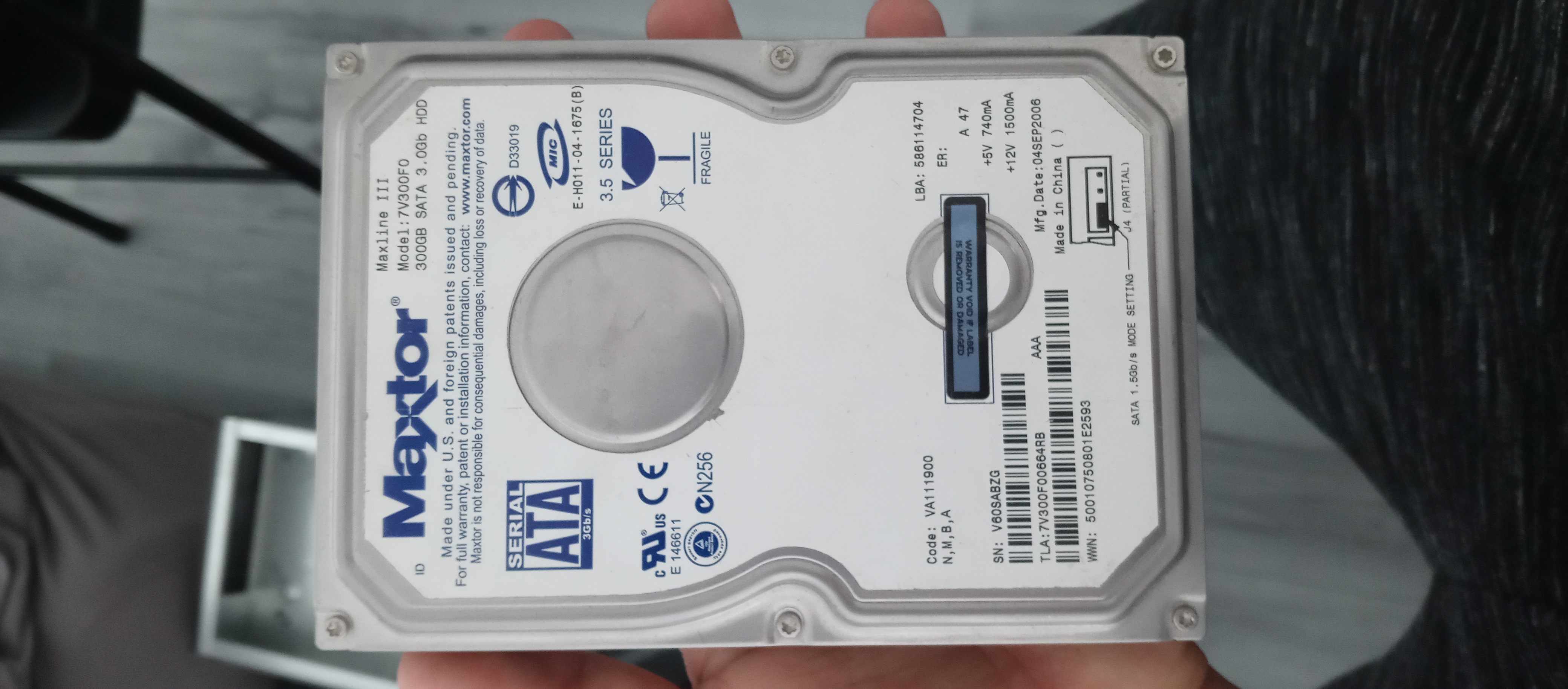

I have tow internal hard drives from an old pc and I want to migrate their content onto my new desktop; however, the task is not proving easy. I bought the SATA to USB cable on Amazon, owned by a brand called EYOOLD, expecting things to work out well. Regardless of anything that I do, it seems that the drive does not appear anywhere within the device manager or disk management. I suppose the cable does work because it has two lights that turn on whenever it is plugged in, but I still can't figure out why the drive does not register. Please help me!
My PC is a Windows 11 Home version 22H2, a 64 bit operating system with an AMD Ryzen 7 5700G processor. Let me know if you need to know anything else.

    Kairo Munoz---you have selected the wrong SATA to USB cable from Amazon. Your HDDs are 3.5 inches and that cable supports only 2.5-inch drives. Either you replace it with the one that costs $16.98 or else get another one that supports 3.5-inch drives. A 3.5-inch drive requires a 12V power supply and the cables for 3.5-inch drives come with a separate 12V power adapter. So make sure you check that before buying.
    Amazon - SATA To USB
    Your two drives are also of two different SATA versions one having SATA II and another SATA III. And I am not sure whether SATA III would work with such cables but you can give it a try.
    Good luck!
