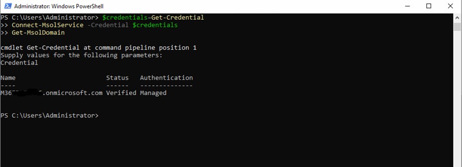

    @Hedi Gardi It looks like their is something going wrong with the status of the verification of your domains in your tenant. Could you please post the output of the following commands;
    $credentials=Get-Credential
    Connect-MsolService -Credential $credentials
    Get-MsolDomain
    If you have a unverified domain I would suggest to remove that domain by the following command;
    Remove-MsDolDomain
    Then run the following command;
    Set-MsolDirSyncEnabled -EnableDirSync $True
    After that, you could check the status of your domains again by running the following command;
    Get-MsolDomain
    Please let me know.

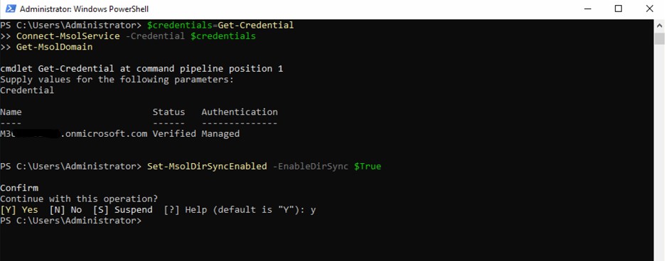

  2. Hedi Gardi 46 Reputation points
    2023-08-23T11:14:11.0366667+00:00
    @patrickmeeuwis There might have been a previous issue that caused this functionality to stop working. However, it seems that the problem has now been resolved, as the PowerShell command "Set-MsolDirSyncEnabled -EnableDirSync $True" executed successfully and the initial error has disappeared.

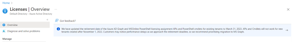

    I faced the same issue while setting up test tenant and didn't found anything on internet that help me out. In my case I found a lead when I tried to setup another test tenant: User's image
    Microsoft actually updated commands for AD sync. Please run Update-MgOrganization with your Tenant id and then run ADsync, it will work. You will need to install module Microsoft.Graph.Identity.DirectoryManagement first to run Update-MgOrganization.
    You can go through following links for more details.
    https://techcommunity.microsoft.com/t5/microsoft-entra-azure-ad-blog/migrate-your-apps-to-access-the-license-managements-apis-from/ba-p/2464366
    And here is the list of commands that has been updated: https://learn.microsoft.com/en-us/powershell/microsoftgraph/azuread-msoline-cmdlet-map?view=graph-powershell-1.0#directory
