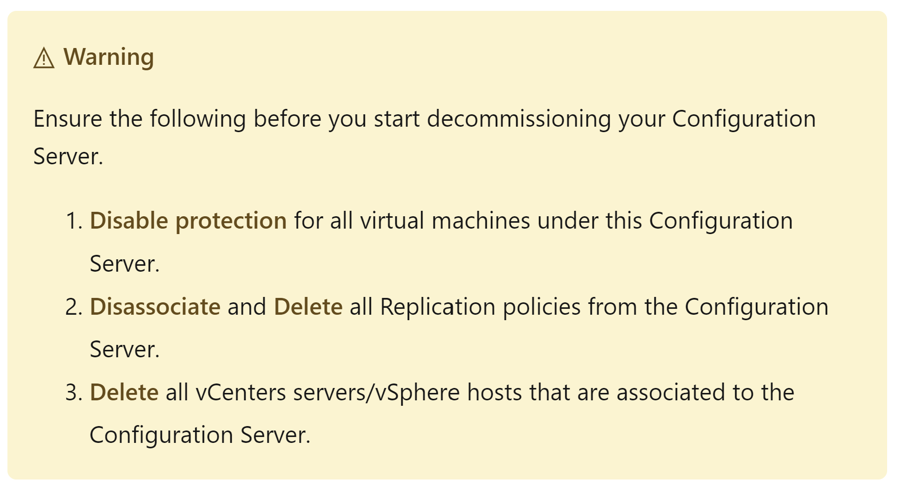

    @Ahmad Radwan Thank you for reaching out to us.
    I see that you want to delete configuration server (CS) (Primary) because there is a secondary CS where all the workloads are running. If you are sure that all the workloads are running on the secondary CS, you can simply delete the primary CS. Here are the steps to follow - https://learn.microsoft.com/en-us/azure/site-recovery/physical-manage-configuration-server#delete-or-unregister-a-configuration-server
    Let us know how it goes!

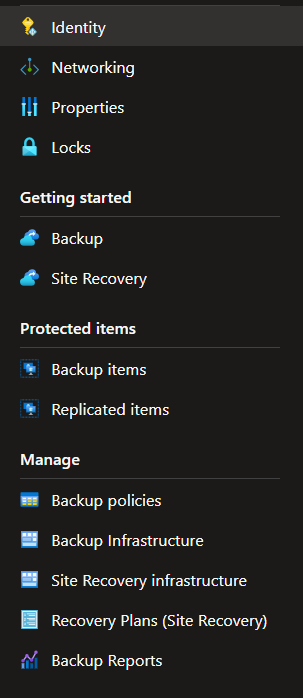

  1. Tech-Hyd-1989 5,821 Reputation points
    2023-08-21T08:55:41.94+00:00
    Hello Ahmad Radwan
    To assign the secondary server to be the primary in Azure Recovery Services Vault, you can follow these steps:
    1. Go to the Azure portal and sign in to your account.
    2. Select the Recovery Services vault that contains the two configuration servers.
    3. In the left navigation menu, select Servers.
    4. Select the secondary server.
    5. In the Settings section, select Make Primary.
    6. Click Save.
    Once you have completed these steps, the secondary server will become the primary server and the primary server will be demoted to a secondary server. You can then delete the primary server from the Azure Recovery Services Vault.
