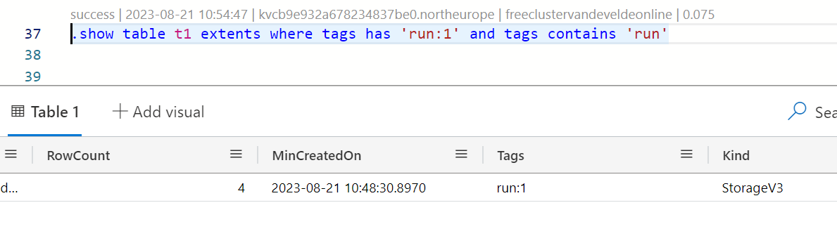

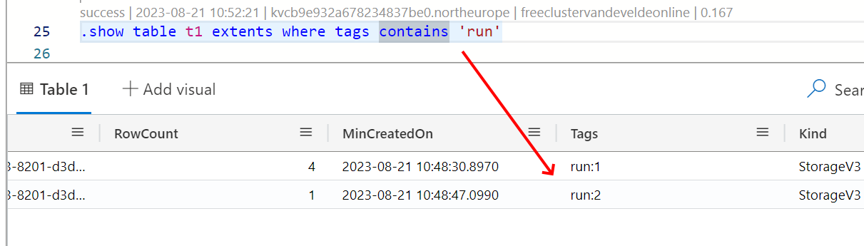

    You can check for the tags with either 'contains':
    Or you can check it individual ones with 'has':
    Now you have control over the tags during creation of records.
