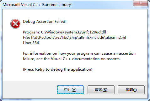

i created a class "myCComboBoxEx" derived from CComboBoxEx, and i was trying to create a CImagelist objective for myCComboBoxEx, when it is running, got a run-time-error:

when it runs to here, "Debug Assertion Fails" pops up....l....

    If you select the Retry option, you'll probably see that the assertion is this one:
    _AFXCMN_INLINE CImageList* CComboBoxEx::SetImageList(_In_ CImageList* pImageList)
    	{ ASSERT(::IsWindow(m_hWnd)); return CImageList::FromHandle((HIMAGELIST) ::SendMessage(m_hWnd, CBEM_SETIMAGELIST, 0, (LPARAM)pImageList->GetSafeHandle())); }
    Which means that at the time you call SetImageList, the combo box window hasn't been created.

    The line in afxcmn2.inl that has the ASSERT is checking for a valid window handle.
    It appears that the code is calling CComboBoxEx::SetImageList before the actual window for the control has been created.
    It's not clear where the method is being called. For example, calling it from your class constructor will cause this assertion.
